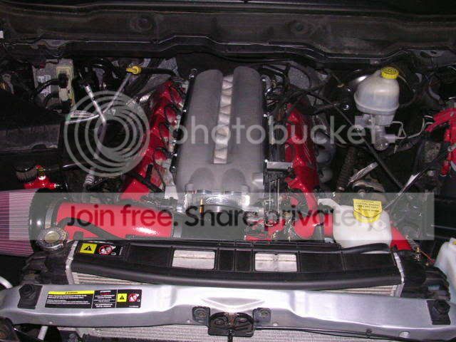

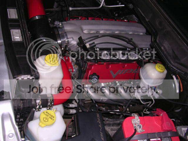

I've been fighting with the lower pipe for over an hour now. I had to stop and clean up some of my blood. I'm pretty sure I got the wrong size hose clamps with my pipes, as they won't fit over the lower fitting on the block. I had to fight with the uppers too, but those clamps lost the fight with my giant Craftsman screwdriver( thank God for the lifetime warranty:) ) Anybody have a quick suggestion before I go to O'reily's and get larger hose clamps? They all appear to be 2 inch clamps that came with the pipes.
I also had a hard time fitting my upper clamp....i just used the stocker clamp on the t-stat housing:dontknow: Have not had any issues and its been on there for about 5k miles...
I ended up using the stock clamp on the lower hose at the block.
But man...does it look GOOD.
There should be clamps labeled 213 and 200, the 213's will go at the block connections, 200 at the others.
