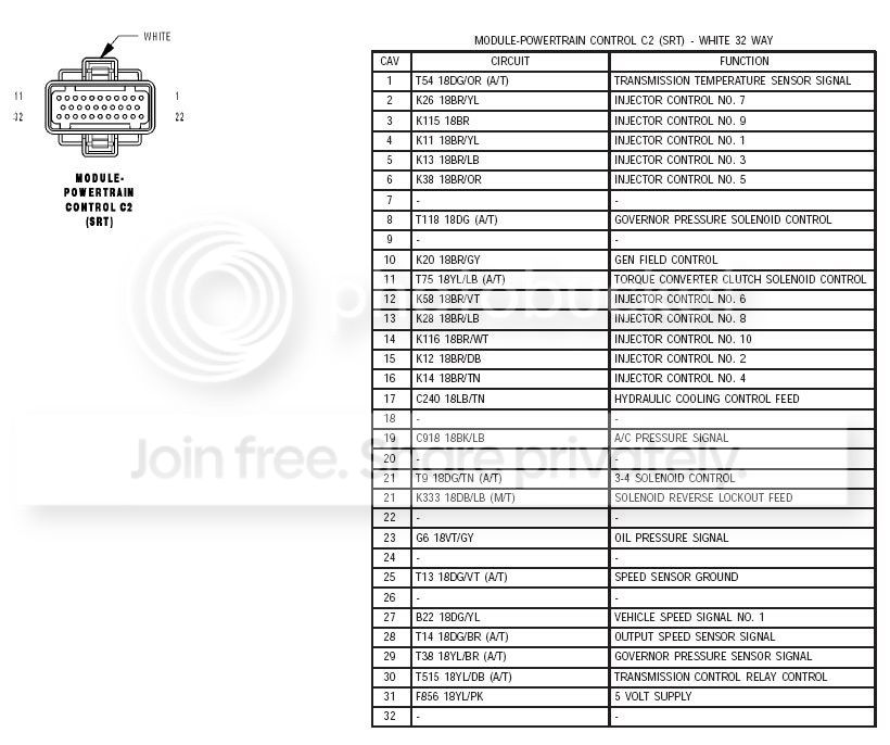

ok so i'm been installing a Trick Window Switch All day long....well it's all hooked up and ready to go i've gotten all my wiring strightend out and it is correct.... but i'm not getting anything going from the switch to the noids....i've got a Flashing LED.. to let me know when it's spraying.. an i know it's working cause i can jump a power wire to the noid and the led works....so i'm thinking it's the BOX.... i'vv got my Tach/RPm Wire going to the Blue/White Wire on the #1 connector pin #1 and i've got the TPS Wire on the TPS With the Brown/Orange wire....are these correct?
Rpm wire=
.. Pin #1 is circuit K133 dark blue/white for coil control #4
Pin #5 is circuit K134 dark blue/yellow for coil control #5
Pin #7 is circuit K19 dark blue/dark green for coil control #1
Rpm wire=
