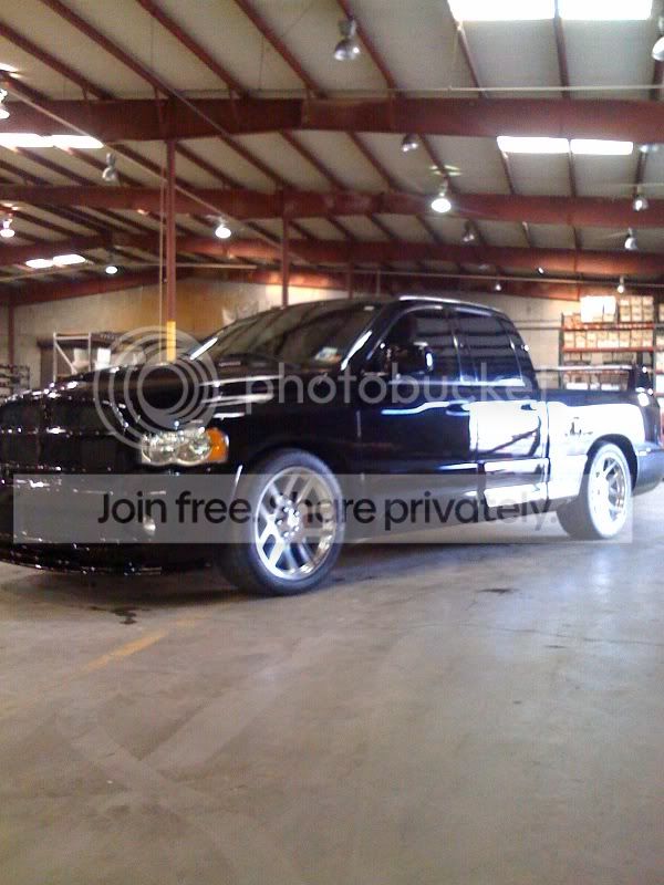

Hmm sounds interesting....all you have to do is swap out springs? any ill effects? I think i would like a small rake....
your truck needs it it looks like your f going four wheeling:D

I run em on my 10 an the only ill effect I have not fixed after about 10K miles is the bump stops. I sit about 1/4" off of them and if I hit a hard ass bump it is basically bottoming out on the rubber snubber of the bump stop. I am going to shave the stop down and reweld it on the frame. Ride is really great as it is not a heated or coil cut spring. Rather a spring made for a truck 5-600 lbs lighter. Takes about an hour a side install from lifting/supporting truck to bolting the wheel back up and letting her down.:rock: :burnout:
