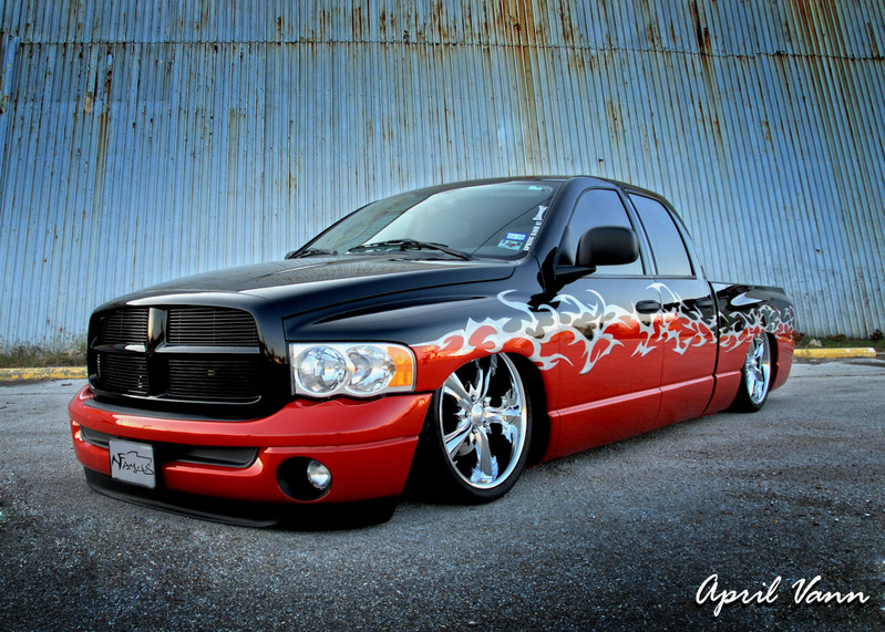

man yall we are going to have somebody make a front kit.... i used to build air ride suspensions.. its not going to be a bolt on kit.. we are going to have to find a good shop i already have mine Nfamus AirRide and going to have it custom made and taylored to our own trucks... it's not somthing you want to cut short......up front you should be about to replace you coil springs with bag Cups and put a bag in there and regain the lower height you want ... this is my guys that will end up doing my work for me http://www.nfamusairsuspension.com
here is his ram
and after it was painted and made a few mag's
here is his ram
Do the airbags affect the handeling ? or just the height of the truck ?
and looks great.. good link...
yes the handling is much improved! and it rides like a caddy! if set up the correct way there will be a major improvement in handling traction and lowered stance... i don't want my truck to lay on the ground i just want to be able to put the bottom of the nose about 2 1/2 inchs off the ground!:rock: :rock: :rock:

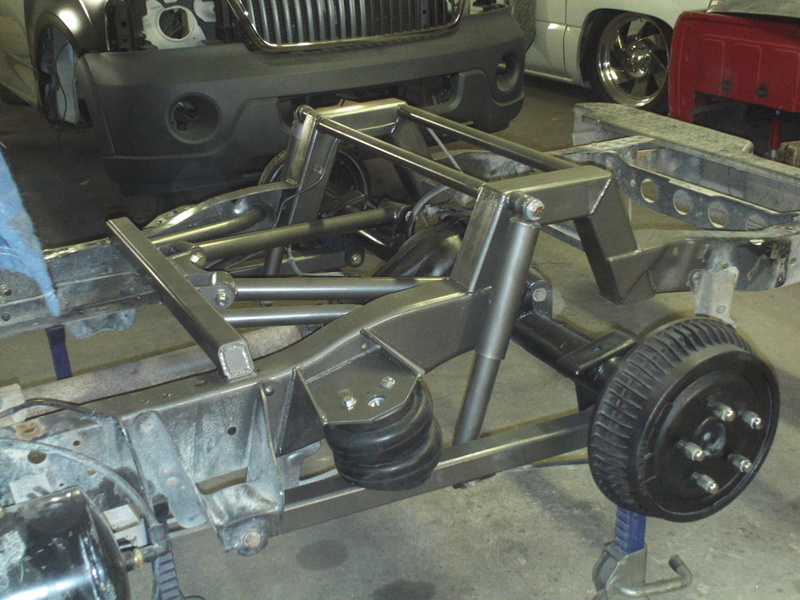

heres a perfect example of a 4 link... some of you may ask why the bag on bars.... you can do it either way but bag on bar is alot better ride and more control when going around turns as the body shifts bag over axle is normaly for towing or a cheap set up unless you going to run coilovers
