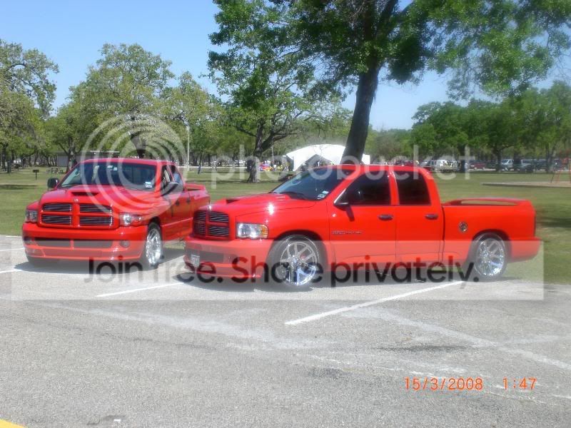

Now on the cheap, a local buddy of mine cut 1/4 or 1/2 a coil out of the front springs and installed a flip kit in the rear.
It looks awesome and it rides like a stock truck only it handles better......... the rear end geometry is good. total cost was 300 bucks..................
his is the lowered one:)

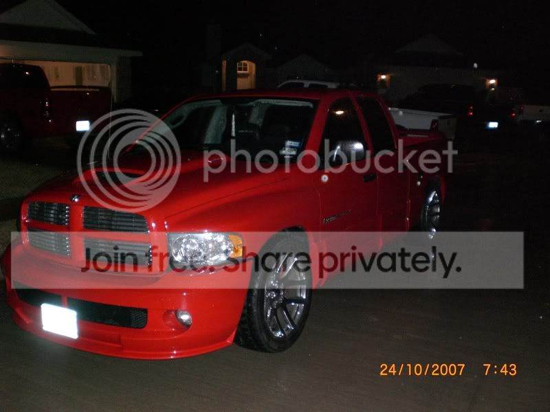

Could you take a pic of your lower control arm?
