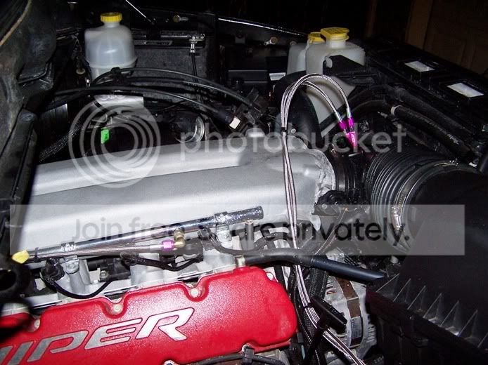

I started with the 75 shot for a couple hits, then said screw it. I went and bought some new NGK 2 step colder plugs and went straight to the 125 shot:rock: Big difference!! Definately feels like a 12 sec truck, I cant wait to do exhaust and intake mods now and let this puppy breathe. I wanted a very clean install but I also wanted the nozzle up top for ease of changing jets. Sorry for the wet dirty engine bay pics, it started raining before I took them.
My friend did an Awesome job on the install for me! Tell me what yall think
Here is my new little red switch
Bottle fits nice and clean under the back seat
I used my extra battery tray for the Zex brain
Nozzle on top(125 jets in!!)
ntw0rk said:
Very nice install job!!!
How long did it take?
It took my friend several hours but he is very picky. I have fuses and relays and all kind of shit that didnt come in the kit he added, all wires saudered(sp?), loomed and heat shrunk. He runs a car audio store so wiring is his specialty.

WRX:D I like the clean install...I'm going to do similar but thought about mounting my solenoids on the K&N heat shield:dontknow:
thats a good idea, it will keep the solenoid cool since there not attached tothe motor. Heres another way to do it which keeps the motor clean looking
