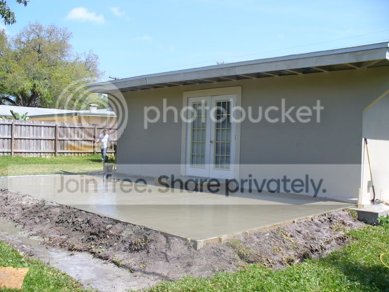

Thank God this is finally done...been a hell of a week:rock:

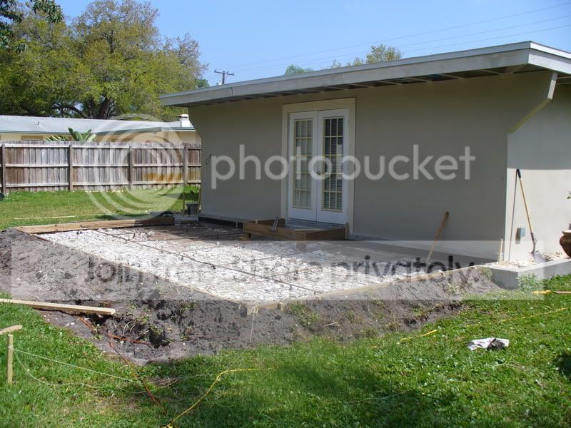

Dad and I been forming this up, and we finally got her poured yesterday... with the help of some friend's...13.57 yards of cement.
Go figure...you would think I would be sleeping like a rock all night...:dontknow: no such luck.

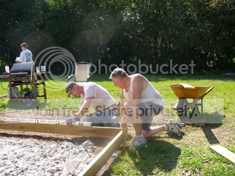

Dad and my neighbor Tom

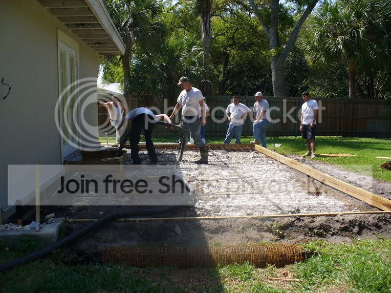

Some of the fellas.

MAN!!!! That's a LOT of "crete!!!! :eek:
Looks great, Ken! :rock:
Thanks bro...glad we covered it up last night with plastic...raining real good as of 04:30... should be to your place by noon.;) :D

Thanks gang, I just got done cutting the slab's... and it's setup nicely. Were really happy with it, water runoff is flawless...no pocket's or puddles.:rock:

looks good ken. how big is the pad in the back? i did a 15 x 20 pad last spring, so i know what you went through with that. mine was 7 yards of concrete.
The back slab is 27' X 14' X 9", front porch is 22' X 8' X 5" with a 22' X 3' X 5" sidewalk... all 4000 psi with rebar/mesh/ and fiber :)
