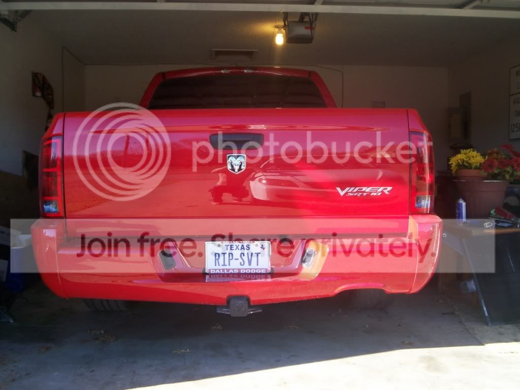

an also in this pictures you can see how unlevel my lowering kit it ...any body got any clues on how to fix that?
Your whapsided:p , let me know how much, I think the blocks you got from me?
but let me know and we'll see if we cant fix that;)
thats one thing I have never understood, ya drop both sides the same, and they turn out uuuuuuunnnnnnnnnnlevel:argh:

no thats my gf's mazda lol and about the lowering kits yeah stink it's your blocks.. but i'm going to wait until the motors in the truck b4 i go saying it's sitting sideways lol plus it also doesn't help that it's sat for almost over a year with a half tank of gas in it....... o an i only weigh 176 i got love handle muscles lol:rock:
Measure from the frame (not suspension pieces) to the cement and see what you get.
And if you got a half a tank of gas on one side and no exhaust system on the other side, that may add to it a bit too

the passanger sdie has exhaust system but not the tips anymore i'm waiting on the new motor going to try to stuff 2 4" tips in that little hole
They all sit sideways, when you get it running find a local spring shop and they can level it up for you rearching the springs.
good call i'ma check it out
