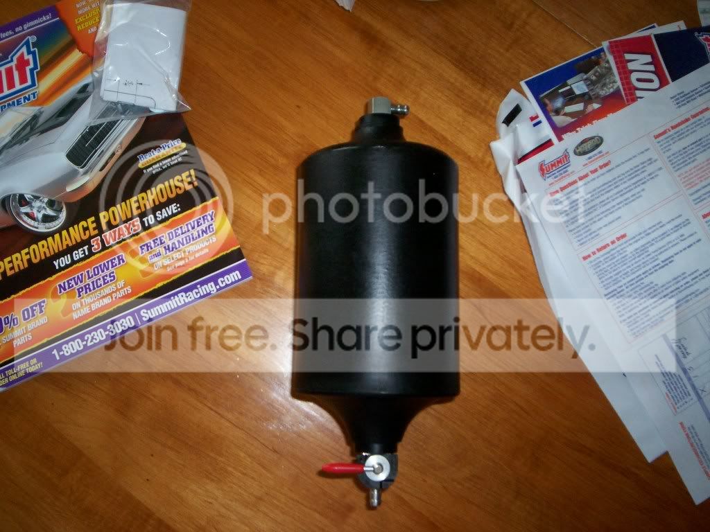

Ok here we go Got the goods "

Out of the Box

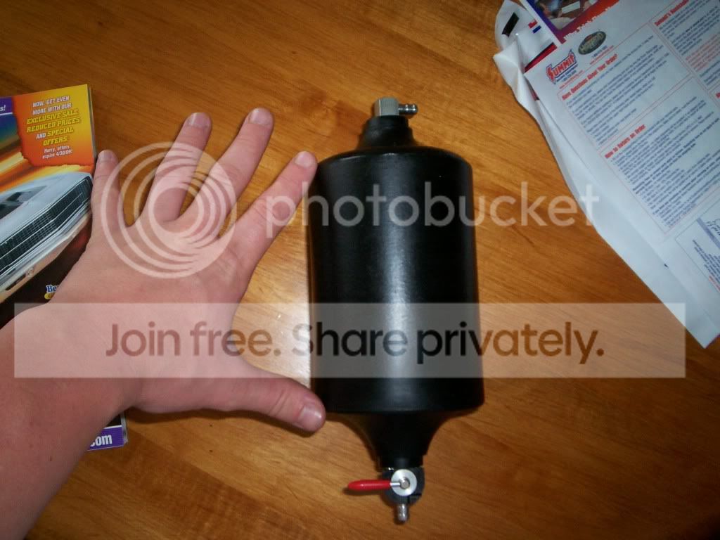

Heres My hand For Size "Small Little Sucker Ain't it"

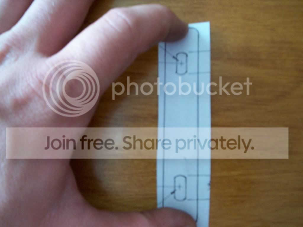

Niffty Little Template

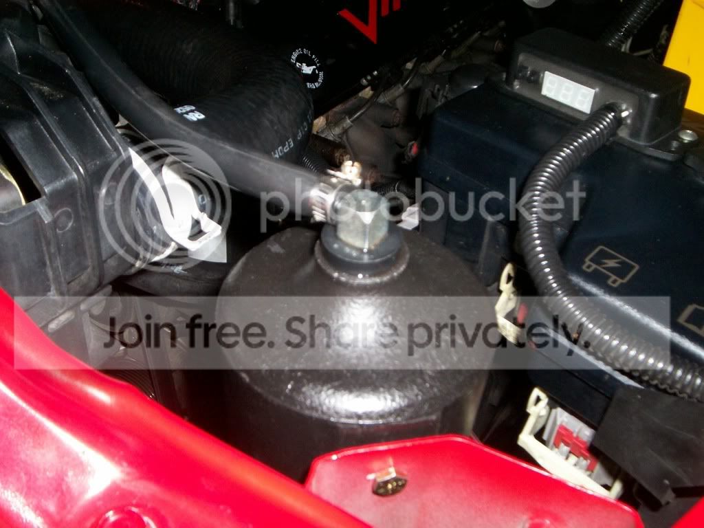

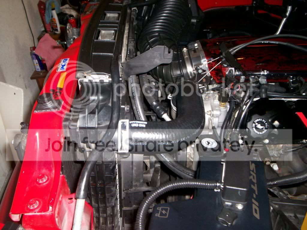

And it Installed
Took 10 Min After i got it out of the box and installed.. Looks great and Is at least 19 Pounders lighter lol With Coolant in it
ooooohhhhh....they have it in RED too!
let me ask though..as the engine cools/heats will the water flow back into the engine from the can?
also noticed they don't come with a vent...that a problem?
there is a small vent at the top on the back side of the can.... an the stock one didn't have anyway of being put back into the motor.. or at least mine didn't
i might be wrong but wasnt the orginal one larger so it could hold more coolant? is the smaller one you installed going to be of adiquate size? if its not and the engine pushes coolant out then it will over flow and the same will be true if it wants more coolant.
just a question :dontknow:
yeah, thats my concern when the engine needs some agua, will it be able to pull it out?
