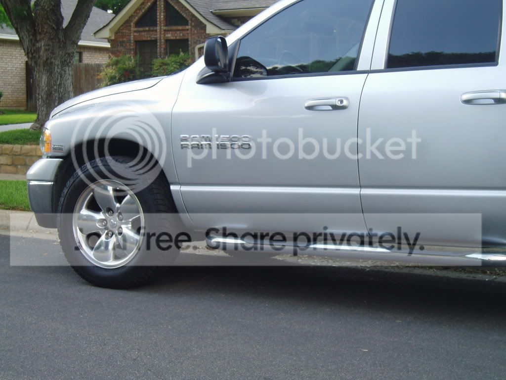

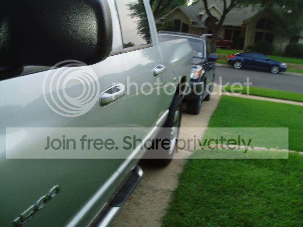

yes i have some. the pics are just comparing the painted to the chrome ones. been really lazy and havent made the swap yet lol

Hey SilverBullet... did you paint your door handles using this method as well? If so, did you paint them while they were on the truck, or did you remove them first? It all looks really nice.
same way and i took them off. rear handles are a pita but it was worth it.
