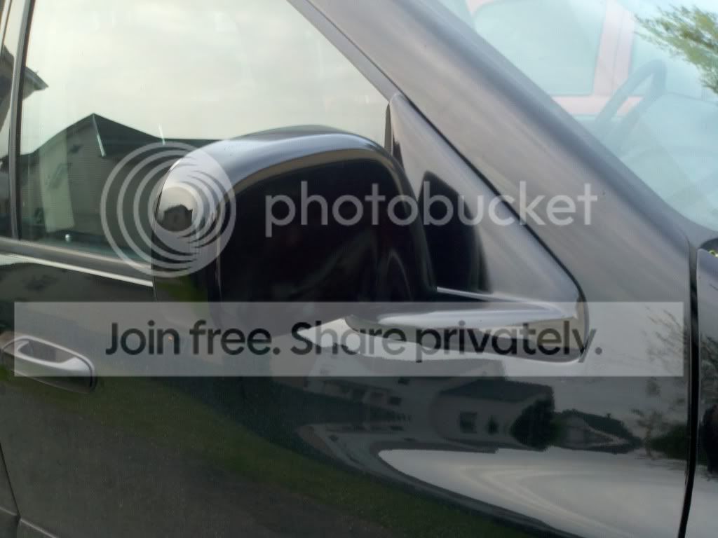

sorry dont have any really good close up pictures but i did the mirrors also you can see pretty well on this one i think.
Wow mirrors look great!! Did you paint them yourself? ive been wanting to do my door handles, mirrors and wiper cowl also...
yeah painted mirrors and handles myself just dont have a good close shot of the handles. sanded them first with 80grit to knock off as much of the wrinkle to the plastic as i could then 3 coats black 3-4 coats clear coat.

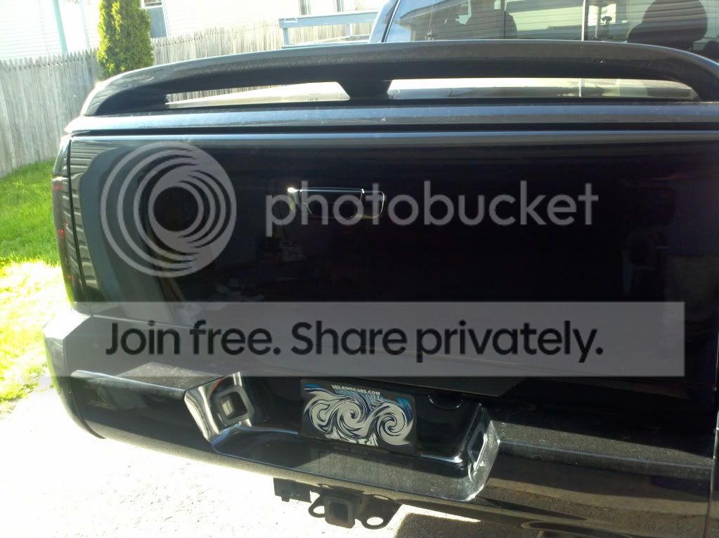

this is about the best i have of how the handles look this is the tailgate handle.
