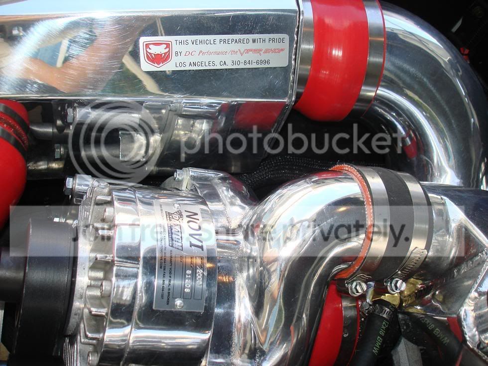

DC finished work on my truck this week. Dc inlet, Paxton, Dual channel wideband A/F, and DC Tune. I have pics for you.

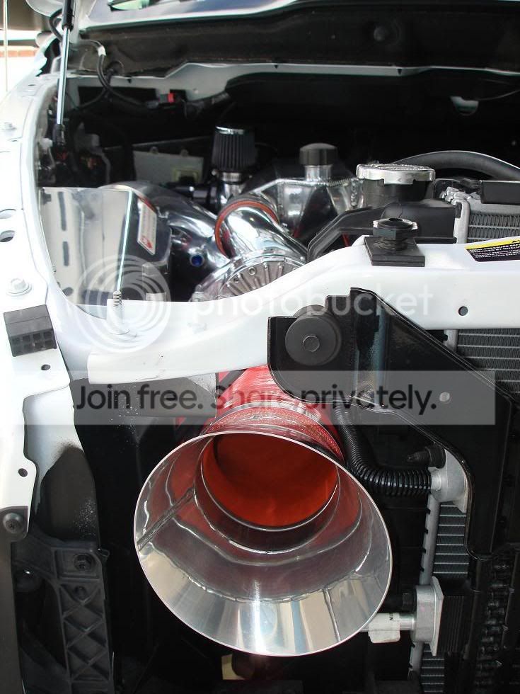

The big sucker
Nice looking wiring

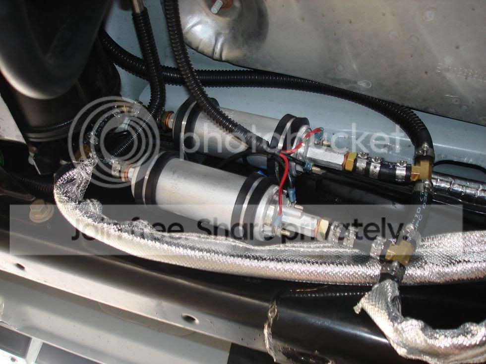

Fuel Pumps

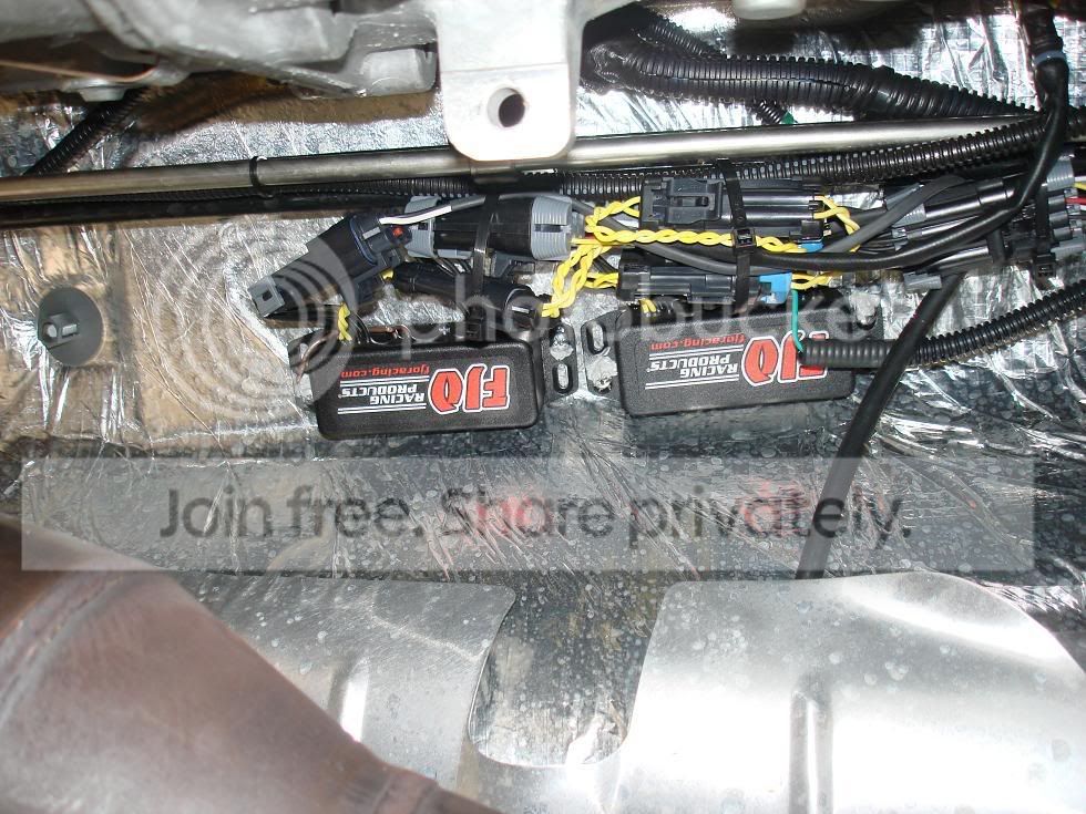

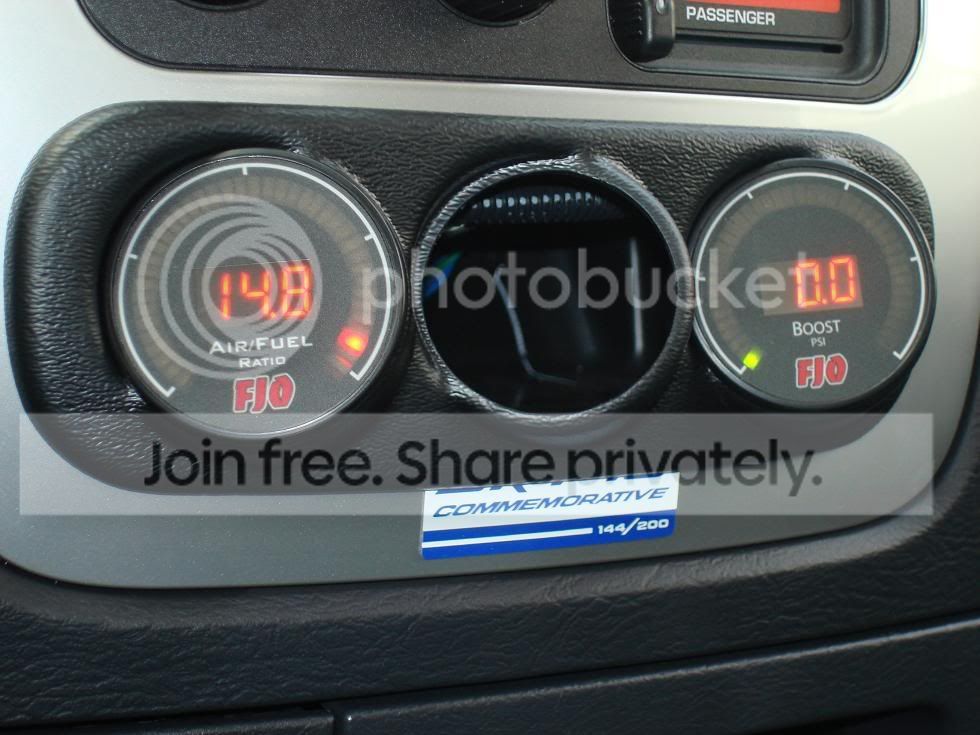

FJO Dual Channel Wideband AFR
What is that cat still doing there?
What to put in the center? Any suggestions?
What Commemerative Edition badge?

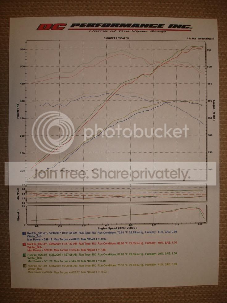

The baseline run is the truck stock with a flowmaster muffler only (the one Roe used to sell) 400rwhp. With blower 561rwhp.
The truck runs good.

I would like Nowwhat to take a good look at picture #6. DC is using the same crimp clamps that Boomer got criticized for using on Ricardo's truck.
There is nothing wrong with crimp clamps by the way. If they are installed incorrectly, or if the crimping tool is damaged/worn there may be an issue, but no one should be criticized for using them.

Appart from the fact they look shyt,aeroquip for me:D

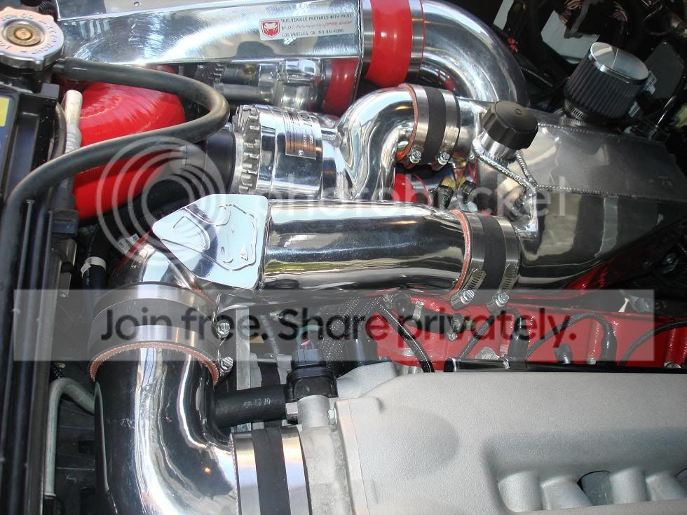

you will like it, wont be long before you have a smaller pully and a few other mods to get you at 700hp. give you about a week before it feels slow lol, also watch your connection between the blower out let and the aftercooler, they tend to blow off. had to fab a bracket to keep it from blowing off.
Just add water/meth and a tune and wa la...700 rwhp :)

are pic's some misleading or is there electrical equipment rather close to the exhaust - cats ?? :dontknow:
telephoto lens makes it look flat. There is plenty of space. Shouldn't be a problem.
