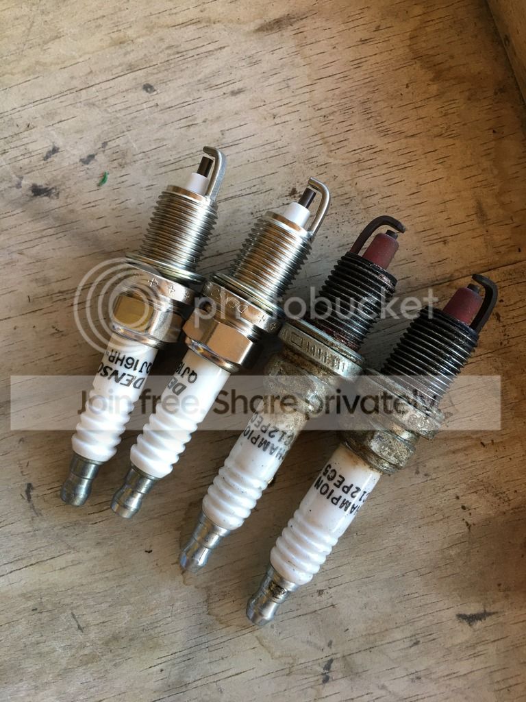

So not much going on today and I been waiting to order new plug wires debating on the stocks or msd's, I decided to look at the plugs and swap them out, well 1 they were bright red and 2 they were sitting at about .020 gap instead of the .035 the guy at the parts store gave me some densos although I seen that it had champions in it
Which are champions right ? The guy at the parts store said these were the best !

The guy at the parts store is a Viper mech apparently? Don't trust the ones who seem to know it all at the parts stores, they usually know the least.
Yes champion is stock I believe. In a lot of threads many guys run these they say that's what works.
Champion only! Unless boosted or spraying.
When I do my wire swap I'll swap them out again, any specific number ?
Neither of those plugs is correct. Therefore the terrible burn on the used ones.
Champion only! RC12EEC or 438 they're also known by.
.038 gap
