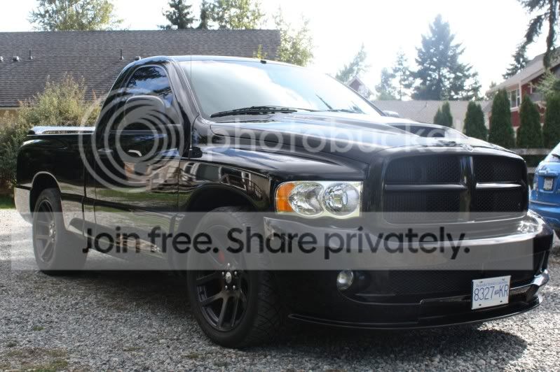

Wheels should be powder coated tomorrow, will post pics when i get em on
Finally got them on. I think they turned out pretty well. Going to clean her up and take some better pics later
