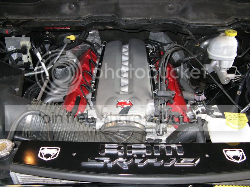

Yesterday i spend some time on making an aluminium bracket for a sneaky pete emblem. I used the 2 upper bolts of the trottlebody so sneaky pete is in the front of the intake manifold and can protect the V10 now :D :D :D
It was cheap and very easy but it's always cool to make something for the truck :top:

like the cover on top of your radiator more, where'd ya get it ?

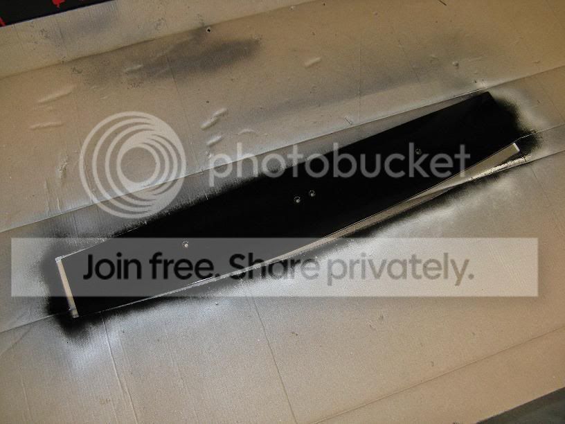

It's my home made radiator cover as well :D I Made that last year. It's easy to do. Make a template of cardboard and saw/cut it out aluminium plate.. File it smooth and drill some small holes in the cover for the small screws. After that you paint it black and put a Ram SRT-10 door emblem (or something else) on it with 2 small Viper stickers. 1 hour work and it looks great :top:

Hi Venom.. I think that i can't make a polished fang emblem because i need to mill the fang emblem into aluminium and i didn't have the tools for that. Maybe it's possible with a mopar oem fang emblem or with a polished fang hitch cover? Try to make a bracket into your garage because i can't buy the mopar fang emblems or hitch covers overhere in Holland so i must order from the US and they must ship to Holland. After that i can make a bracket and put the emblem on and must ship it back to the USA. 2x overseas shipping make it to expensive.. Just try to make it at home because it's very easy. Take a small piece of aluminium plate, make a template of the up side of the trottle body with cardboard, than saw it rougly out of the alumium plate and after that file it smooth so the emblem fit perfect. Drill 2 holes for the 2 upper bolts of the trottlebody and bent the bracket a little bit so the stance of te emblem is nice on the trottlebody. Put the emblem on the bracket with self adhesive tape and you can put the bracket with the emblem on the engine :top:
