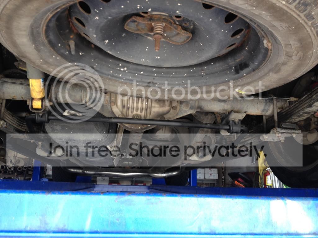

I know it has been done. Wanting to hear from some one that is actually driving with this set up. Is the ride much harsher? What's the main benefits? Would I be better off just using a helper air bag set up instead of swapping leafs. I have all the parts laying around to do it so price really isn't a problem. Thanks for any help or info.

The rear is stiffer, I love it! Handles better, carries more weight, doesn't roll around corners anymore. I used a RC 4.10 rear as well to complete the package. They also lower a QC once installed obviously. Great mod in my book. Rick (phxpoolguy) has done it as well. I also did a QC that was still auto and he wanted the heavier springs and 4.10s. He's said it's one of his best mods.
