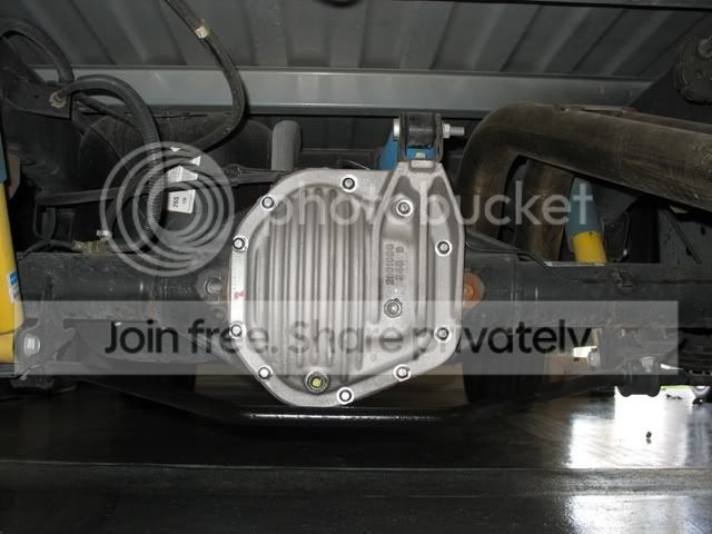

ARP makes fine stuff, but for my ride I went as close to OEM as possible without all the corrosion.
18 months later and they look like new.

I did read the thread and there is good info in it. I appreciate the work you put forth in selecting the bolts that you did. I did some research of my own and selected the ARP fasteners that I have listed. I have an ARP catalog since I have bought fasteners on many occasions that aren't listed for a particular application (I have also spoke to the ARP techs on many occasions looking for a unique fastener for a particular application). The bolts that I spec'd for the rear differential are not headers bolts. They do have a larger head and flange on them. Their strength far exceeds the OEM fasteners and they are stainless. I was looking for something nice that was not going to corrode.
Also, I used blue Loctite on mine. My factory bolts had a locking compound on them.
