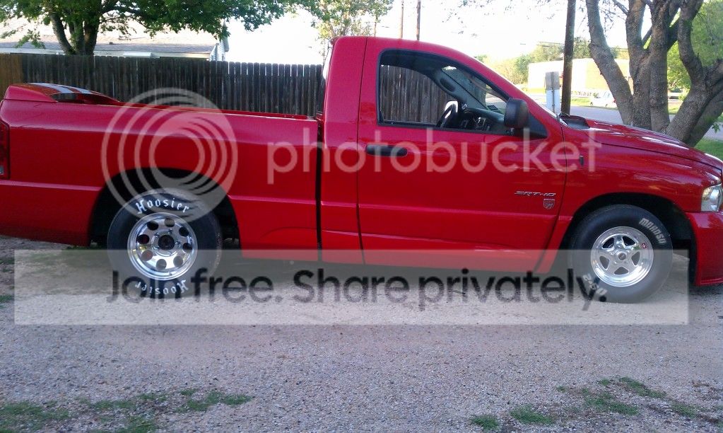

I run a 15x3.5 on the front, with a narrow enough rim/tire you can space the wheel far enough out that it sits in front of the brake caliper instead of having to be big enough to go over them
Do you have any pics of those wheels on your truck I'd love to see it
Can you pm me the info on how you did it like did you use wheel spacers and do you know the back spacing thanks
1.5" thick spacers 1.375" backspacing on the wheels. You do have to grind the corners of the calipers a little bit but not much at all. I think with a 17x3.5 rim you could clear without grinding. I used to have pictures from when I mocked everything up ill see if I can find them. And it will pass NHRA tech inspection at a drag strip.
Not sure what happened to the pictures I took when I did it but I can't find them anywhere
Yup, but since the wheel ends up infront of the caliper instead of around them it shouldn't be too much different, need to get venomous to see if they'll bolt up to his without issues
That would be cool. would love to know how it works out on his truck. Your trucks looking pretty mean in race trim homie

I run a weld with adapter now, I'd only use the bogarts for the track anyway
Dom's setup I wouldn't recommend until you get close to 4000# race weight. It stops good but its just much smaller than stock. He has 12" rotors front and back with 4 piston calipers in front and dual 4 pistons in back. Manual brakes too (WAY easier to work on the drivers side of the engine)!
