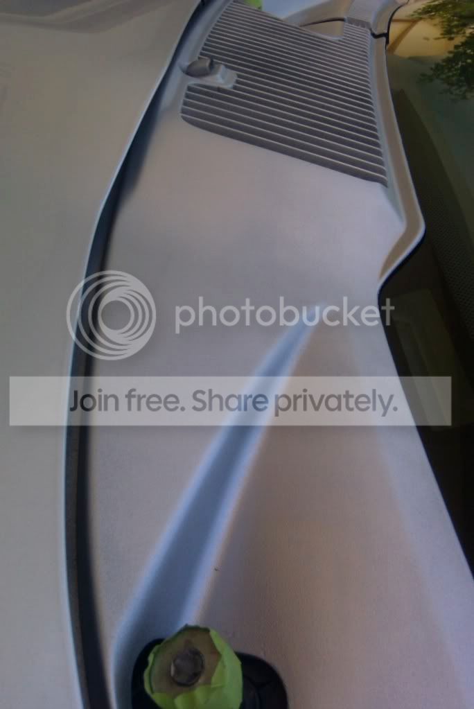

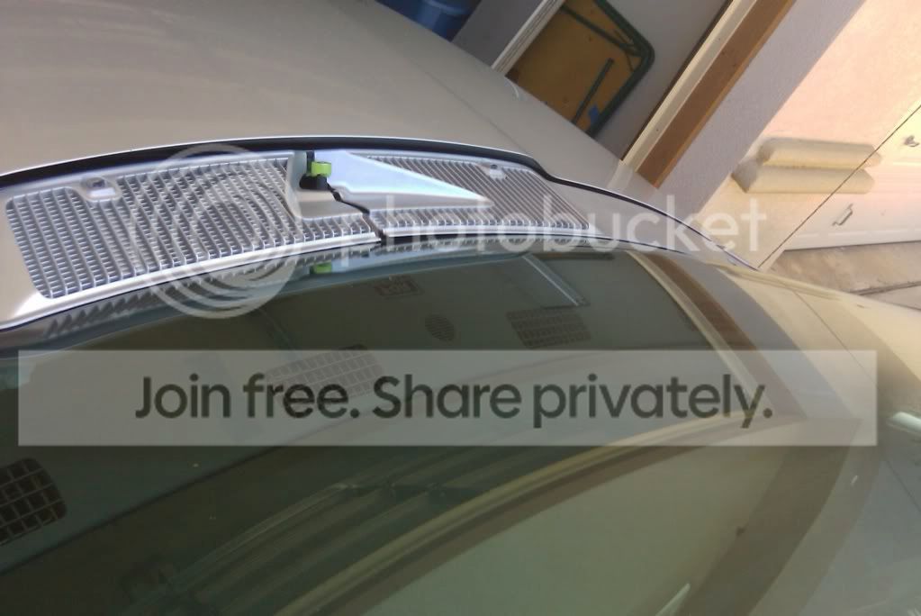

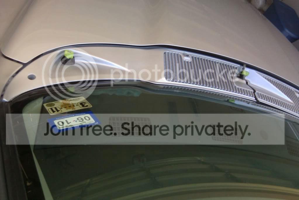

Well I was bored and hated looking at the faded black plastic so i changed it up :D

What's the best way to go about smoothing it? Looks awesome!!!

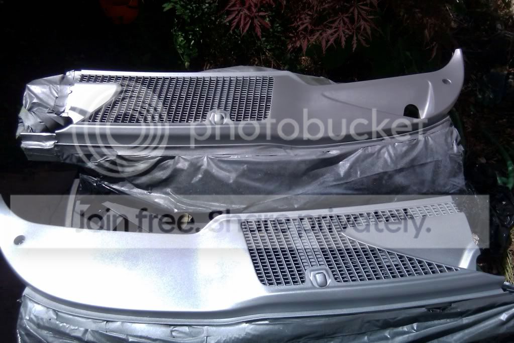

i sanded with 220 grit till smooth and then filler primer and then sanded that with 600 grit...
Sweet, that should work with the mirrors and door handles too then right? Any special paint to use?
primer...i would guess plastic primer...i can't remember what kind it is...the plastic pieces flex a lot in the heat and cold...i think the clear should be that way to, if i remember right...
