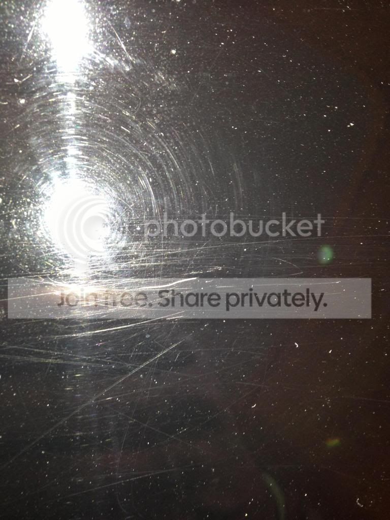

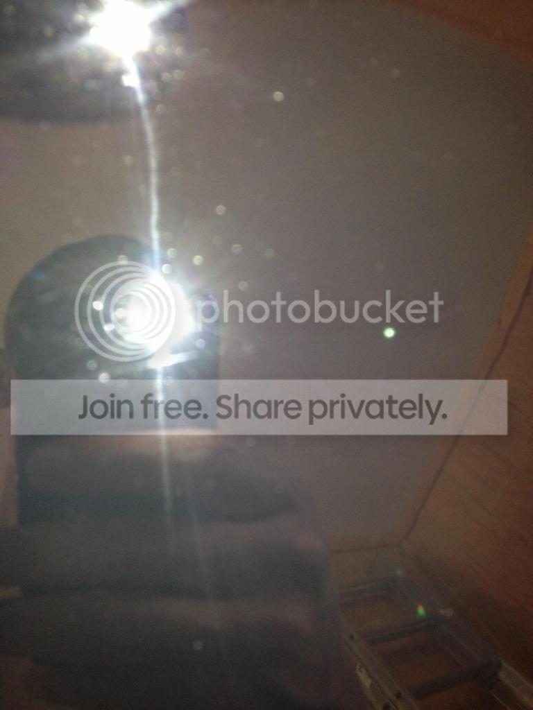

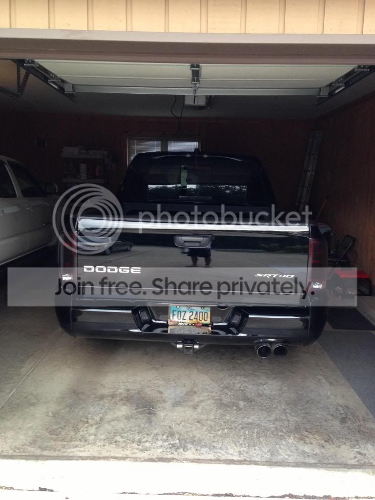

After washing and waxing my truck sometimes I take a few steps back and look at it sitting in the shade often thinking damn this thing looks almost looks as good as the day it was driven off of the showroom floor.. Then I would pull it out into the sun and curse a lot because the paint looked absolutely thrashed with scratches and swirls. Well, yesterday I took the initiative to buffing the whole truck with my porter cable 7424xp and some Lake Country foam buffing pads. After numerous hours in the garage, I can now say the truck looks 99% better. I still have several small scratches but ALL of the swirls and hazing are gone. It wasn't sunny when I was done so I'll have to post some daylight pictures today but you can definitely tell a difference in some of the pictures.
Scratches and swirls before
After
