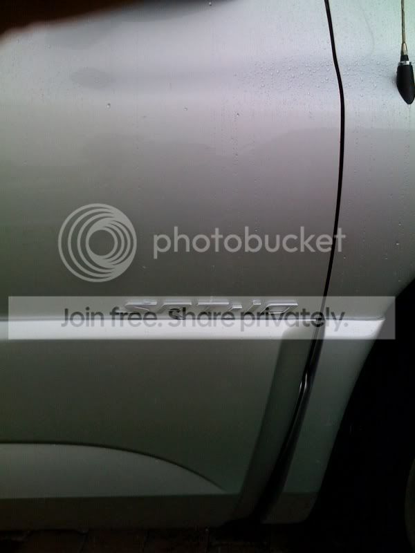

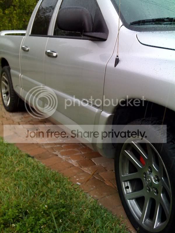

Thanks for the advice on emblem removal! Here are the after pics!!!!
kickinassrt-10
Mar 6, 2009
2,577
Miami, Fl
Thanks to quite a few of you who helped with suggestions on how to remove my emblems. I got them off, down here in Florida it doesn't really help using a hair dryer..I used fishing line then use glue remover and removed the excess foam/glue form the badges. I used 3M double side foam tape from any auto store and put the back on...Here is my finished result, on only one side..the weather down here cut my project short due to rain:( :argh:
Black1 said:
I like the placement on those... I don't think I've ever seen anyone else put them there..... It looks great! :) :rock:
Thanks I didn't think anyone's was there, so I went for the unique-ness i guess :dontknow: :marchmellow:
