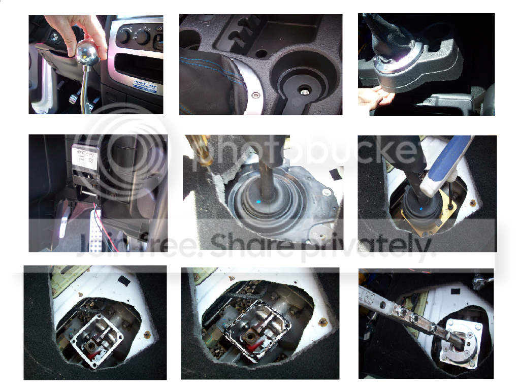

Does anyone have a copy of Tony's shifter install instructions they can send me? Scan or fax? Lost it somewhere and want to get this mod installed today if I can!:burnout:

sorry man, made a big mistake welding the other day and havent answered voicmails or emails, but I can see them today, but here ya go boss

my grandma can install that shifter ,,,butch up sally slap that puppy on there
Good to hear it is a piece of cake to install, I should have it done before I even get a beer buzz:D
just get on level ground ,put it in neutral and yank the old one and bolt it in ,leave bolts just slightly snug ,sitting in park depress clutch and go through gears ,,,tighten them down go for test run before you slap consule on if good put it back ;)
