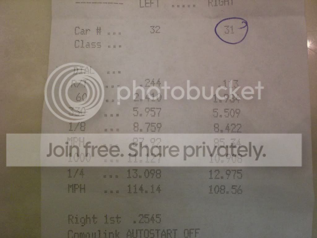

My time slips
:D I'm very satisfied for street tires and my first time in running this truck...
I was #31. #32 is a 2005 Corvette.
First Run
Last Run
Super reaction time on the last run and for stock tires your 60' times were great. ET's were excellent. You did good!!!
