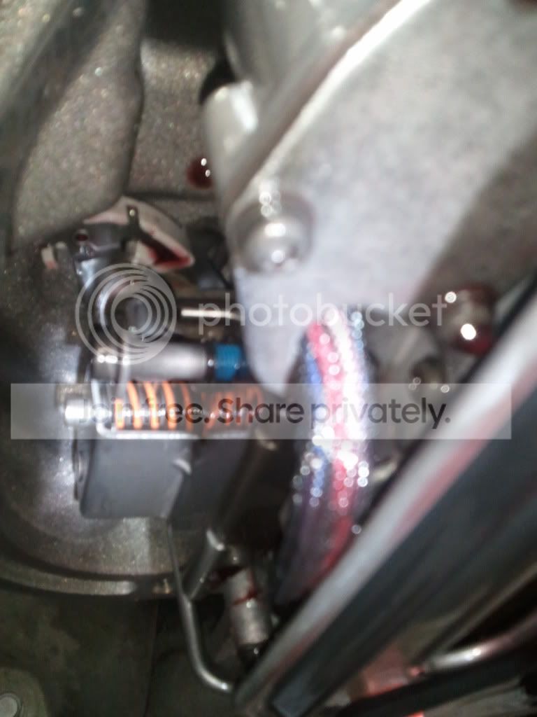

what did you end up doing with the valve body 1 or 2 holes also...if its shifting two hard you can use this to adjust it... Heres a shot of the hex bolt to adjust the pressure.
Its the hex bolt on the end of the orange spring. To do it while its in the tranny you'll have to cut a allen wrench quite a bit...the closer you get the plate to the head of the bolt the less pressure...Transgo instructions say to back it out flush if i remember (could be wrong)...the only thing that sucks if you have to pull the trans pan off just to get to it and if you dont like the adjustment you have to do it again...believe me I know...lol
