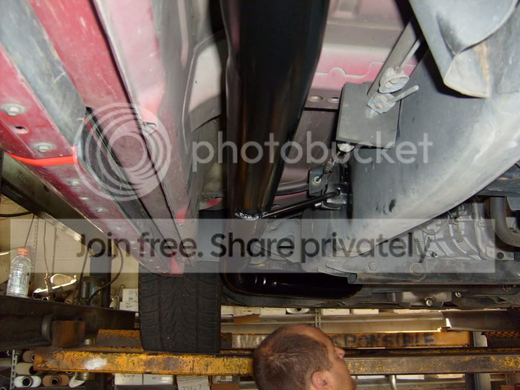

With all the stock exhaust cut off this is what it should look like

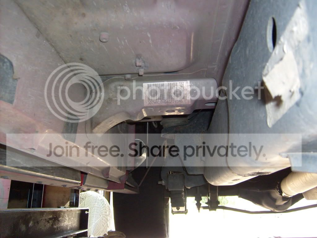

This is on the driver side but this is the place we are trying to get the pipe threw

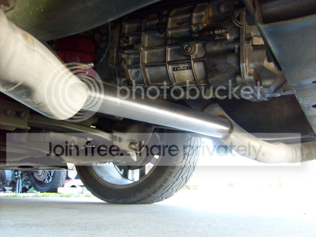

Here is where you can see how the pipes must be bent to get them out going down the frame rails it pretty much looks like an S
a diffrent angle looking forward looking at the same S

heres a picture of a piece of the bed removed this is a must if you want to fit anything bigger than 2.5" pipe if you run the pipe this way
H Pipe Between the 2 Pipes
let me know if you guys need anything else!
Good pics toole, it would suck to have to pull the tranny with that setup though :eek:

i replaced the clutch with this exhaust set up... trany slid right out the back! didn't even unbolt the exhaust
Nice, why did you add that center pipe? To equalize the exhaust pressure :dontknow:
