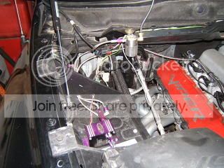

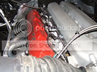

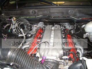

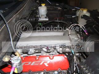

Heres what a zex kit looks like installed in our trucks. enjoy:p
[/IMG]
[/IMG]
any questions. trucks a little bit dirty so:thefinger:

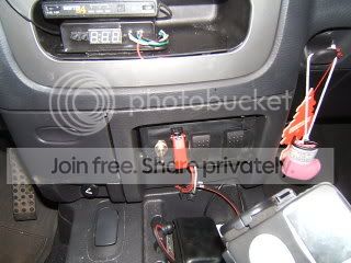

$780 and that was with the traction control window switch, that was 169 so for 600 bucks thats without the traction control but I suggest you get it. It is great for our trucks.

Very easy with this, I did it in a hurry so I did not really care about hiding it. Plus total install was 1 1/2 (I turn wrenches for a living) so avg joe 2 to 2 1/2 hrs hardest part is routing hoses from the bed to the engine compartment and the switches can be concealed also if you can think it can be done.

One thing about hiding the nitrous is if you plan on running it at the track the nozzle or injectors have to mounted at the 12 oclock position and visible, just FYI at least out here they go by the book. thats another reason why I didn't try to hide it. you don't have to have the fastest truck in bracket races,ie money to build your shit, consistancy is the key until you play with the big boys 9's to 6's then it is, he with the most power wins.
yes a hiden install is possiable i hide all my own stuff and had the solinoids under the intake

Can you post or email me more pics of your set up? I remembered yours from the PCB gtg and really dig the idea of putting it ALL under the hood. Do you have any problems with it's location,,, like too hot or in the way???
I would think the heat would play hell with the bottle pressures.
