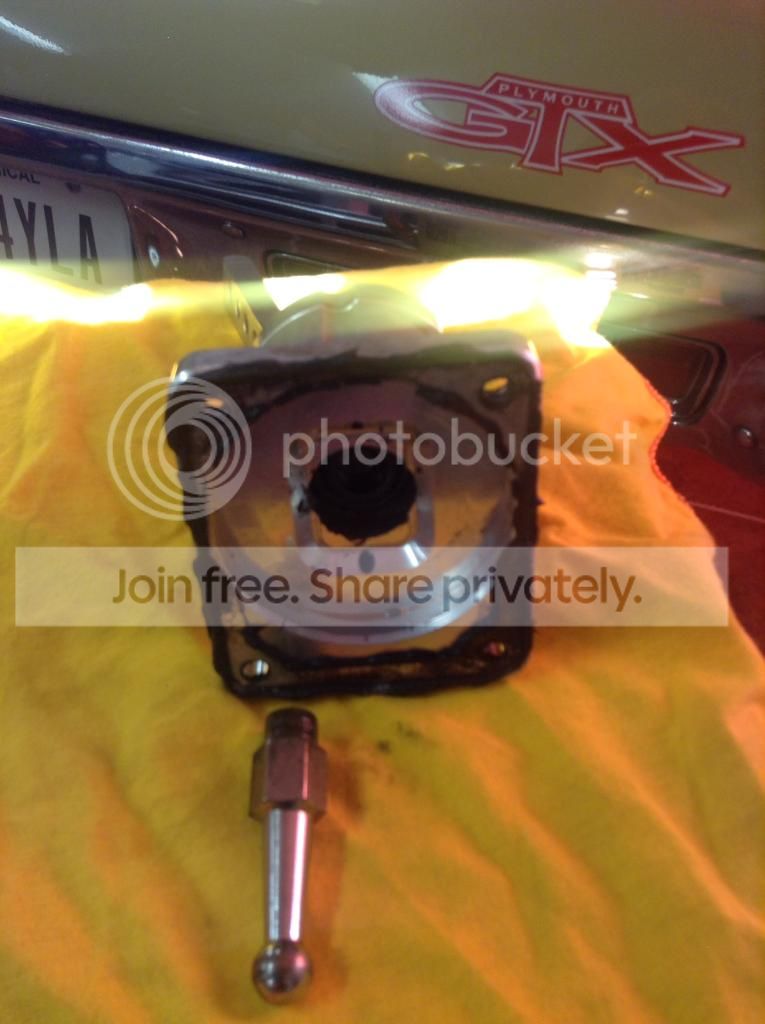

Lost all gears while in traffic and pulling trailer. Had to get towed home. Thought I was gonna have to pull trans but found this.
Well that sucks!
Did that shaft break or did it come unscrewed?

Boomer was one of the original VTCOA vendors. My impression was that he had some good ideas, but mediocre execution and poor customer service did him in.
The shaft broke. Yea, I had a hard time parting with the cash for it , even back then. (I was still working)I never used his shifter handle, it's still in the box. I've always used a pistol grip shifter handle from gun slinger.
