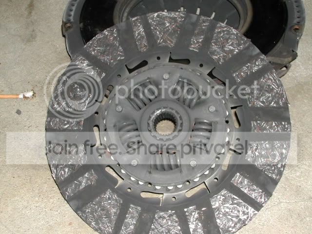

Yup it was the clutch!

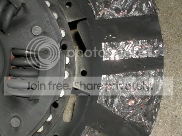

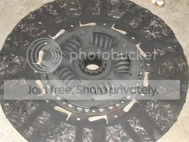

Here's a couple of pic's can't really tell by the pics. But you can see it is shiney the metallic is starting to show through. Got it just in time, there is maybe 1-2mm's left and I was off on mileage I got maybe 10k out of it.

Wow only 10k on a centerforce!!! so did you go with a spec this time ?? Also did you do a lightened flywheel or no!!! I like doing things once so when i do my clutch upgrade i want to do it so it can over handle what i will do
Im going with the Spec III stage, stock flywheel. I know some have the aluminum flywheel, I just dont trust them to not warpas easy as a steel one, plus less clutch chatter with a steel flywheel. It's more of a preference. But I did buy an extra flywheel(stock) so I can have a fresh one with each clutch change. Also centerforce is ok for around 600/650tq at most
anything over that better off going with spec,clutchmaster or act. Unless you got the cash the Tilton is a true performance clutch IMO, but I don't have the cash so spec is for me:D:itsme:
