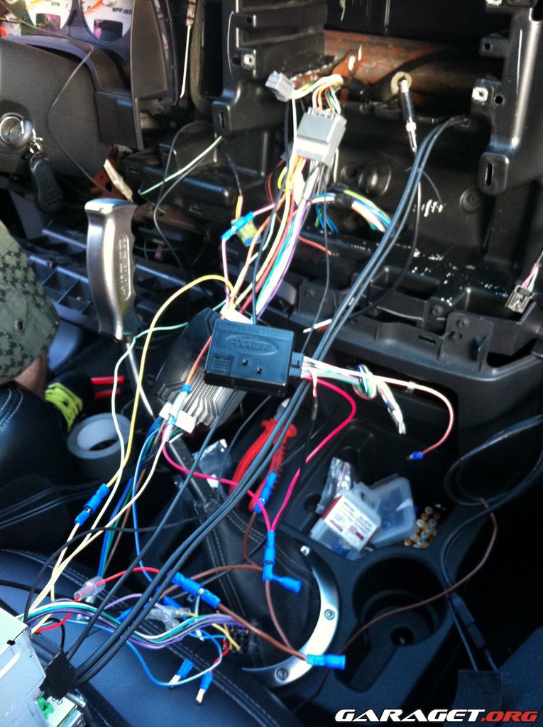

I did the install my self with the DODGE RAM SRT-10 wiring manual and the manuals from the product. I have documented my install so I can probably speed that part up for you. ^^

SRT10R.
Here you have the clusterfuck I made to see that everything works together.
