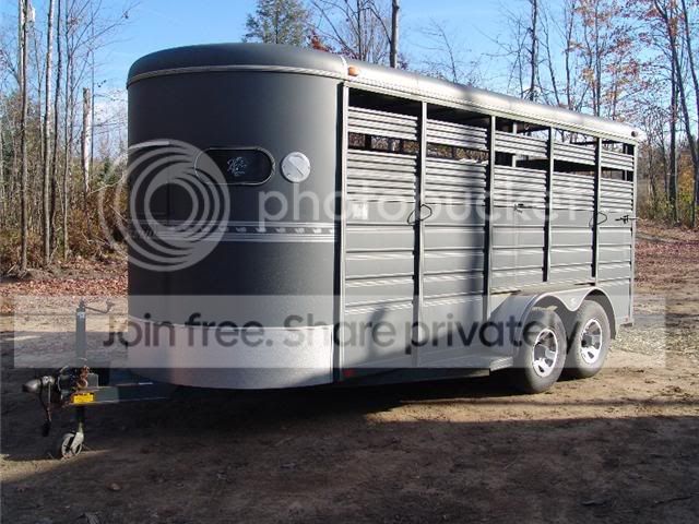

I will be towing a horse trailer that weighs in at around 2800 lbs. Then for each additional horse add another 1,000 lbs. We just got it last weekend. And I know that the trans and rear won't hold forever towing, probably not the motor either, but I will be extremely careful when towing. If I can make it last a couple years I will be financially ready to build both of these up and probably rebuild the motor. Or I may get a new SRT-10 and a Diesel. Guess we'll see.
Here's some pics:
My estimate is a couple times a month taking the horses to trails around the area (<30 miles away) and at least once a month going somewhere to deliver or pick up a horse that is between 100-150 miles away. I think getting out on the highway will be fine though.
