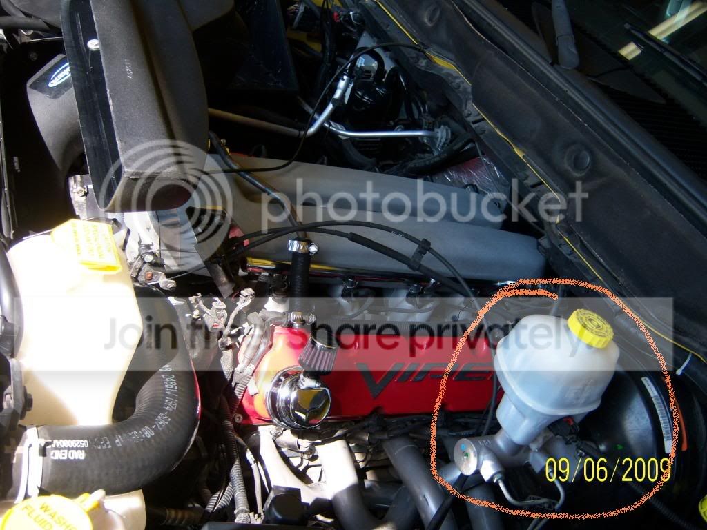

put the header thu the engine bay, on both side this is the only way they will go on :)
on the drivers side you will need to remove the break booster adn side out the way.
it will not be easy but just wiggle the header in to place
good luck

i nevered removed my battery any of that - i just removed this
removed the 2 bolts and side it out the way
