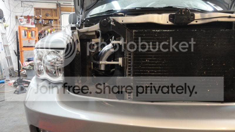

My Cai goes all the way down to the bottom of the bumper.
And,
SOUNDS AMAZING!!!!
And,
SOUNDS AMAZING!!!!
Your statement re-enforces my point.;)
BTW, Harley's sound AMAZING to a lot of people, it does not mean they are fast.:)
