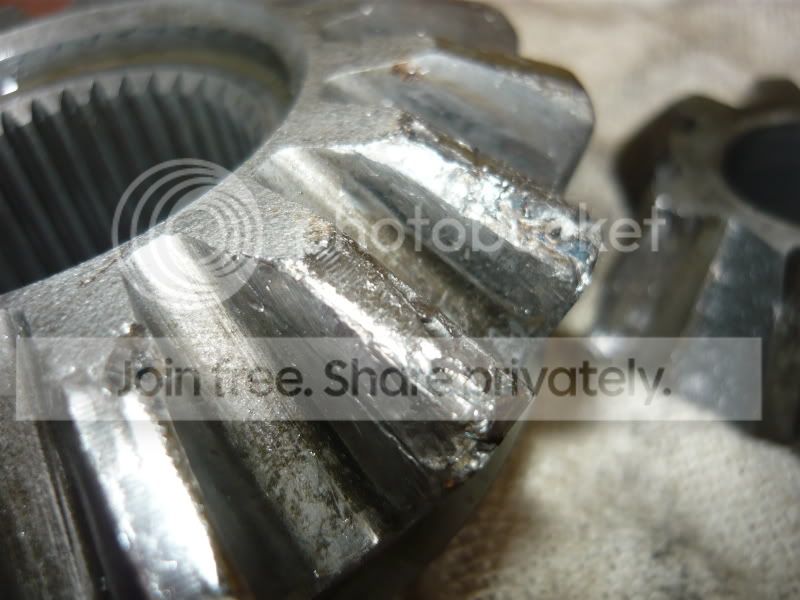

Pulled the carrier on Thrusday night had it cleaned at the GSE shop at my job, but didn't really have time to take any pics until today. Flushed the rearend and axle housings really good today. Preparing for the reinstall of the of the carrier and took some more pics of damage.
This one is a close up of the side spiders.

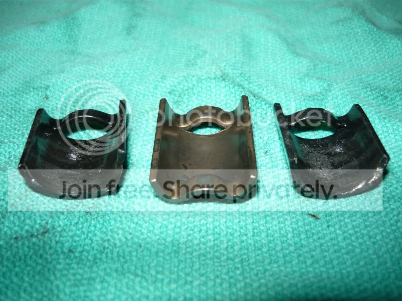

This one is of the the damaged clutch pack retaining clips, and the middle one is the new one. Can you till were the damage is?

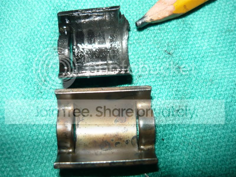

This is a close up of the clutch pack retaining clips next to a new one. Now you could tell were the damage occured.
Now after inspecting the damage my father-in-law and I believe that it was the retaining lips that caused the failure. We think that the of the launch broke the retaining clip causing the clutch pack to spin in the carrier (becasue there was visual scaring inside the carrier on the side were the ring is located). This caused undo stress on the top and bottom spider and sheared the cogs. That's just my opinion, and I'm sticking to it.

The launch had nothing to do with the failure...Its the fact the clutches and hardware were over run while peg legging it and it finally broke off and jammed the spider gears...
