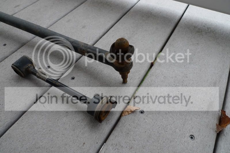

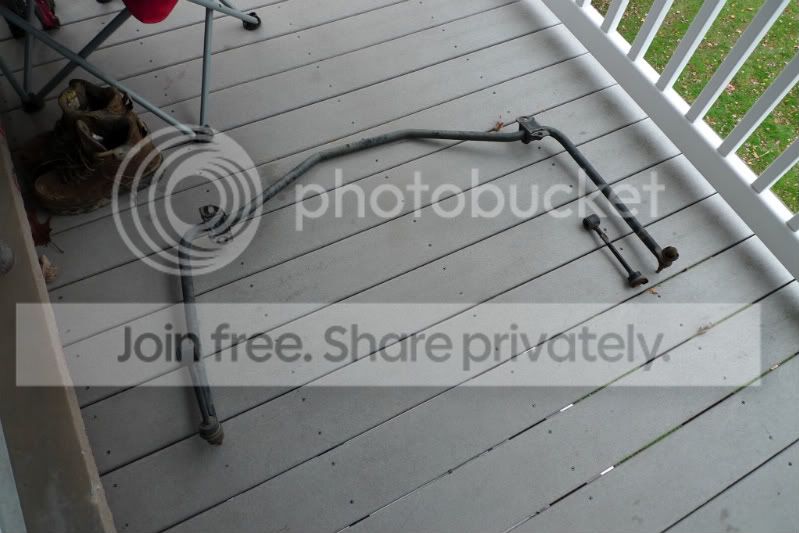

Yesterday I was doing a tire rotation and I noticed my driverside rear sway bar
link was completely shot. The rubber boot covering what looks to be some type
of ball joint was completely torn and the joint itself looked pretty rotten. I was
wondering, has anyone else had this problem? I've done some searching and the
closest thing I could find was about someone actually snapping it as apposed to
having it come apart like this. If you need pictures for reference I can get them
some time tomorrow.

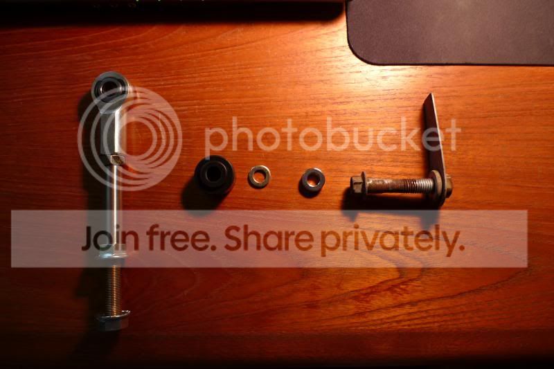

So here's the damage report. I tried to install those new sway bar links but
they would definitely put me too short and the sway bar would be facing up.
Also, the supplied washers don't fit the stock bolt? and there's what looks like
rubber bumpers? that came with the package? very confused... Could someone
tell me how to install this properly?? haha
I do plan on calling Justin in the morning to figure all this out..
