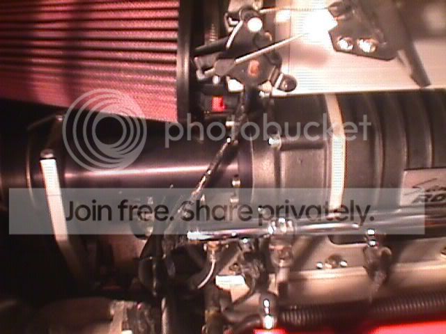

Since it also works on the Magnum engines (318-360 or 5.2-5.9) , it SHOULD work on any Viper engine...........NA,supercharged,flashed or stock.
Very simple install .........just cut one of the wires from the IAT and splice in a resistor (I used a 4.7,but 5 to 7 should also work).The IAT is located just in front of the throttle body in the intake tube on the right as you look at the engine.
Going out to see how much it helps shortly.

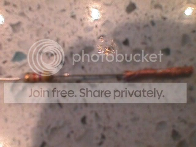

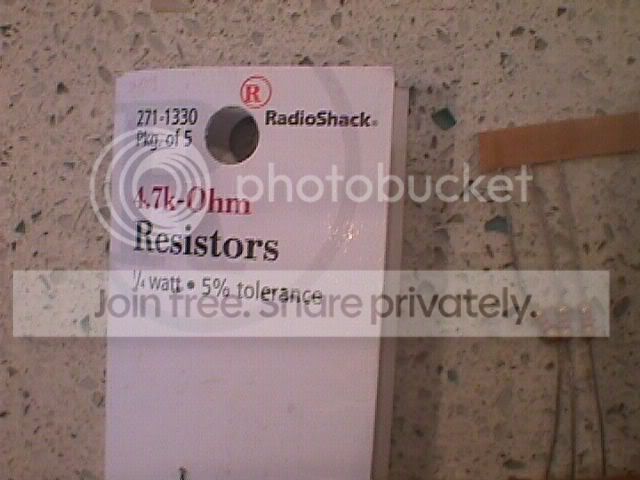

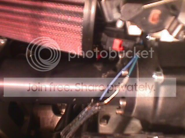

Just soldered on crimp connectors to minimize hassle of soldering in truck. Just cut , insert and crimp to the wire thats NOT BLUE!
BOTH my wires were blue.One was blue with green stripe.I put it in that one.:confused:
I have a Stage 2 flash and it seemed to work fine for me. :dontknow:
Nice pics...personally, I just solder the resistor inline and put some shrink tube over it (don't like crimp connectors - i'm spoiled...I know).
If you have a scanner, you can check the ambient temp before and after the install...it'll be right about 18-20 degrees cooler. Actual resistance will vary depending on ambient temp.
I've put some documents regarding the IAT Adjuster, Dyno results on a basically stock 5.9L, and the schematic for the actual adjustable box. Dyno Run #14 was with the box ON and set at 70 degrees...#13 was using the factory IAT (120 degrees). A/F leaned out a little bit but stabilized on the upper RPM band.
http://www.dodgetrucks.org/bernd/Mods/IAT
The difference in between the 2% and 5% is the variance of the actual resistance value. 2% is just more accurate (5% will work just fine..again, i'm just spoiled). ;)
Sean Roe said put it in the one thats not blue..:dontknow: :dontknow:

The correct wire is the dark blue with a light green stripe, not the solid blue one.
Sorry I wasn't clear.
I soldered the crimp connectors to the resistor out side of the truck. Then just cut and insert and crimp to existing wire. It was easier than soldering under the hood
