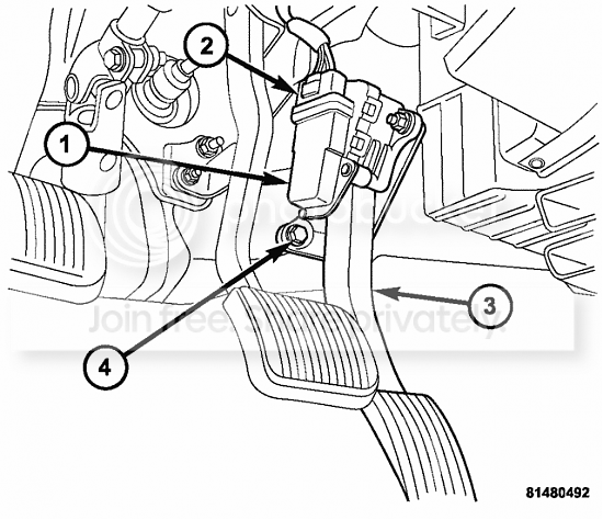

    depends on the gas pedal. I believe if you have adjustable pedals then you gotta get the little box thats on the side of the pedal or the whole pedal itself. #1 is the APP sensor
    [​IMG]
    If you have a normal gas pedal, then the sensor is under the battery. You will need to buy the whole assembly though, sensor and cable together but you dont need a new gas pedal.
    #1 shows the apps cable at the pedal.
