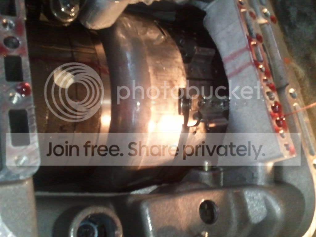

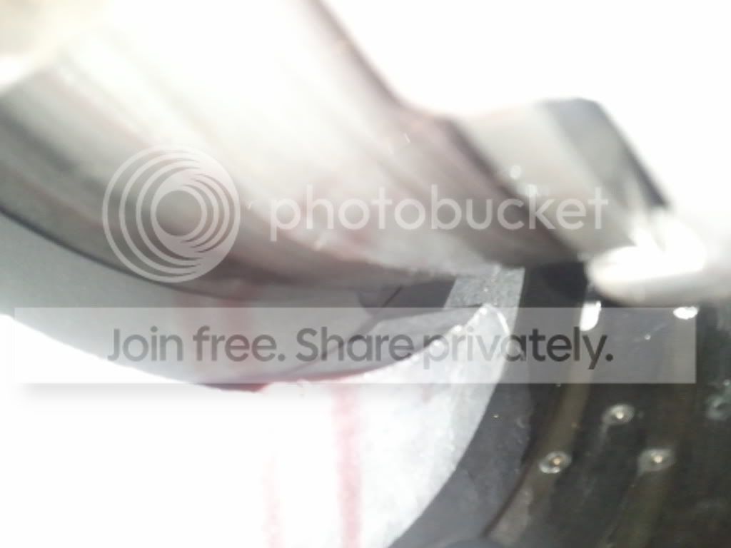

Pulled the pan and the Valve body to take a look at the bank. This is what was in there.
I adjusted the band. The band is just about touching in the middle now even after backing it out a turn in a half (or so). There was some black crap in there but not to much. I guess it was a lot considering the fluid was only a couple weeks old. The magnet had a lot of black on it. Anyone know about how big the gap in the middle of the band should be???
