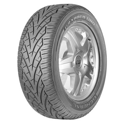

305/45-22 General Grabber UHP Tires - 32.00" Overall Diameter + 12.00" Section width. (V rated)
Summit Part# GTI-15478020000 - $189.95

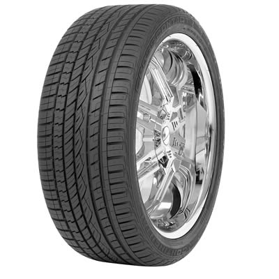

305/45-22 Continental ContiCrossContact UHP Tires - 32.80" Overall Diamter + 12.00" Section width (W rated)
Summit Part# CTL-03545810000 - $189.95

Thanks Voodoo. :) I have been doing more searching (here and "abroad") and so far I am leaning towards the General Grabber tires. Good price, great traction and good looks + they are only 1/2 an inch over the stock tire height, the others are an inch plus. So basically set but is there any reason not to in terms of fitment or rubbing? Anything else one should be concerned about going to 45 series tires? Thanks. :D

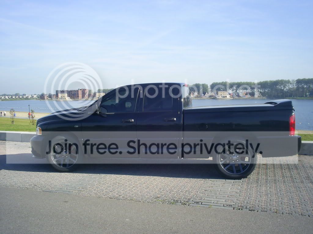

i have the grabbers, 305/45/22. i like it alot better than the stock P Zero's. i also have boomers 2/4 drop. some rub, but mostly if i dont see a dip in the road until its too late.

Hey Dave, that looks sick bud! I'm really liking the look, again (to me) it's very muscular and suits the truck and it's size. If you are running a 2" front and 4" rear drop I should be 100% fine with Stinkers 1.25" front and 2-1/4" rear drop! Awesome. What about when your reverse? Any rubbing out back or up front at full lock, surely? Also, do you think it's worth just doing the back only to allow the front 40 series more turning room or will (should) I be OK with 45s all round. Thanks.

Carl, I put the Continental 45's on mine and the ride did get more compliant due to the taller and softer sidewall. I did notice a difference in cornering. It did not stick in corners like the Pirelli's but I feel the trade off was worth it. I can't speak for clearance because mmy truck was not lowered. I certainly agree that the tires need to fill the wheel wells better. I hate that huge gap. Had I kept my truck it would have been lowered for sure.

i dont have any issues in reverse or turning. only when i hit a dip too fast (ones that sneak up on me)
