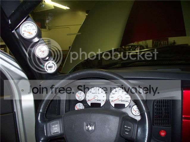

What about gauges? I highly recommend the triple gauge pod that Tony sells (it matches our interior), remove the oil temp gauge and install Fuel Pressure, A/F wideband gauge and Boost gauge. Or leave the factor pillar with the oil temp gauge and get the dual gauge steering column pod that Tony sells and install a fuel pressure and A/F wideband gauge. But then you wouldn't have boost gauge.
I was planning on getting guages but I'm not sure which direction I want to go yet.
I sorta want to keep the stock oil temp guage in the A pillar, and I don't know how well I like the steering wheel mount dual gauges.
I have seen some really clean looking 3 guage setups over on the diesel forum so I may consider something that mounts behind the trip-compass-lie-o-meter lol. I'm not sure yet.
I'm definately getting a 3 guage cluster, just not sure what or where yet...
here is my 3 guage a pillar cluster!!!!!!
Dom, I like the way your guages look... Like I said I kinda wanted to keep the stock oil temp guage in there, but a setup similar to yours would be sweet...
I pretty much have it narrowed down to something like Doms, OR one of the 3 guage overhead mounts that stink has on his website.
I have a little time to think about it so ill see what happens :D
