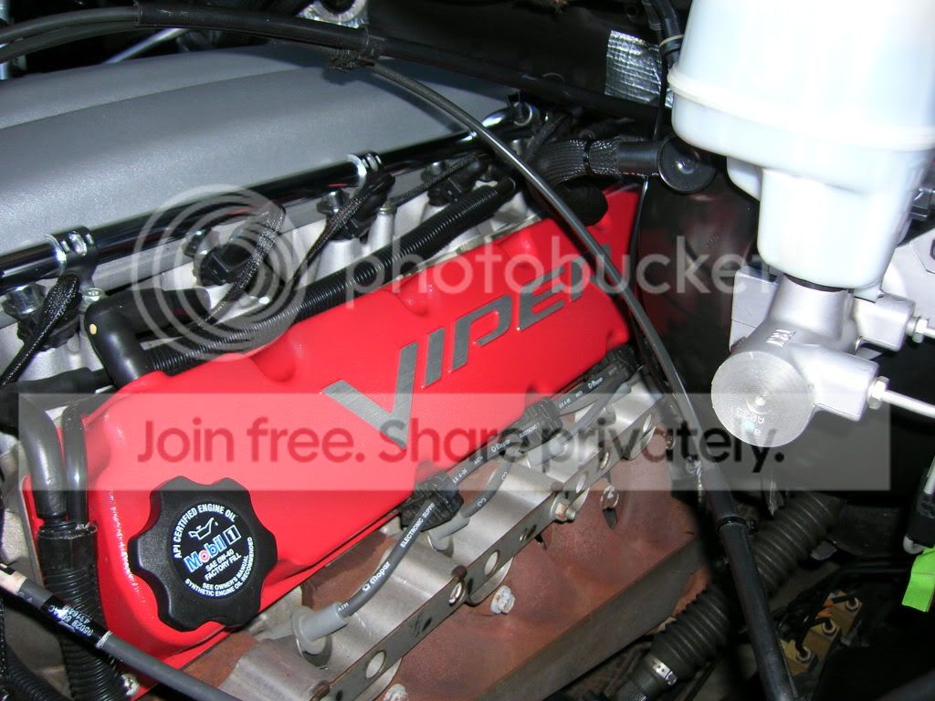

I decided to wipe on my engine bay a little today. The last few times I've wiped it down, I noticed the "VIPER" scripted onto the valve covers is begininning to look like crap.
I started with 400 grit, then 800 grit. Then 1000, and finished with 2000. With the 1000 and 2000 grit I used it "wet" with some detailing mist. I finished off with Eagle One's wadding polish, and my dremel. I'm pleased thus far, I just hope the up-keep isn't a PITA.
FYI: I done all sanding with the sand paper wrapped around a paint-mixing stick so I didn't accidently scuff the red portion of the valve covers.
Before:
After:

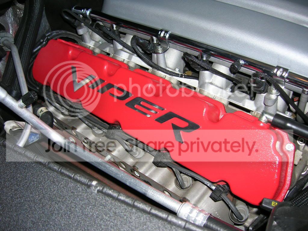

Mine were dirty too Roz...so today I corrected the situation too...but I had Justin do the hard work I just put them on...
Pics with my Iphone...so color is off...they are Candy Red.

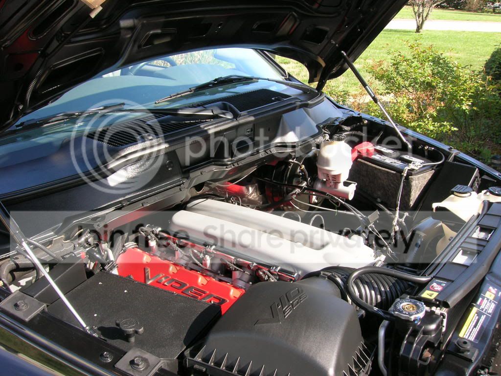

Thanks everyone! It started out being what I thought was going to be "difficult". I wised up and put the sandpaper on the paint-stick and it made things go much faster.
Here are some pics in the sun. I'm pleased with the outcome. It's far from perfect (chrome), but much better than before.
