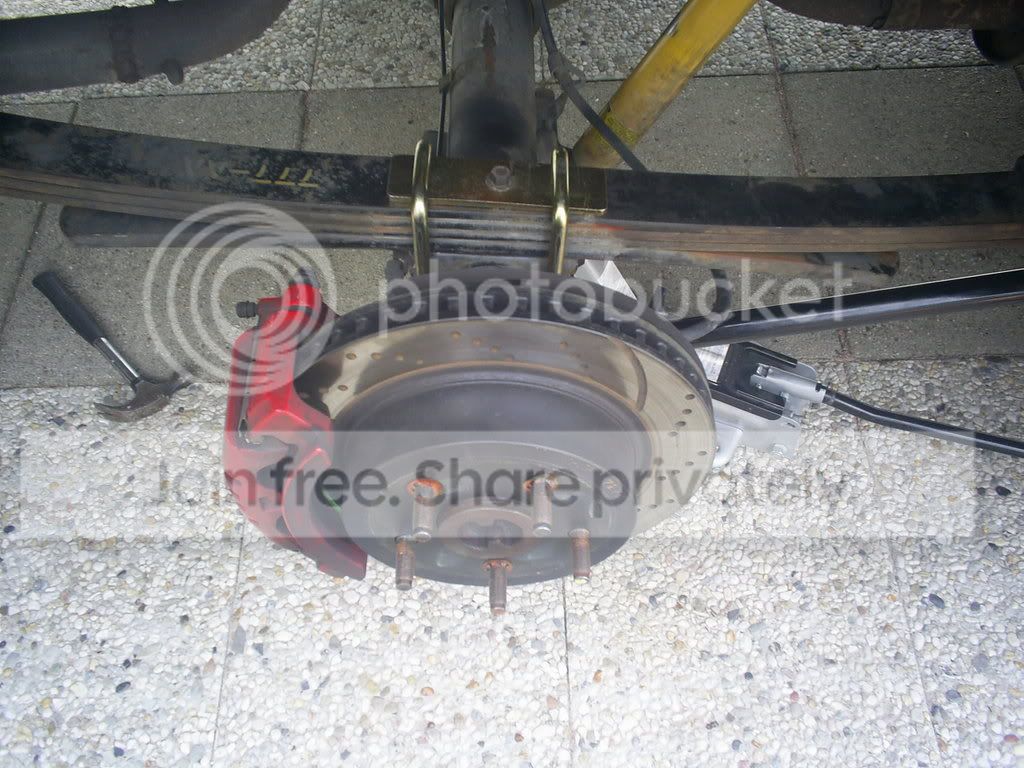

I'm installing caltracs right now and i have a metal plate with a hole in the middle.
On the install sheet there is no picture of this plate:dontknow:
So i don't no where to put it.
Anyone knows?

Ok jsut talked to caltracs , that plate replaces the oem plate on "top " of the spring pack.
You should also have a set of square u bolts, you discard the oem ubolts, and flip the new ubolts to fit the opposite direction of the oem set up, in other words, the square u bolts will go in fromthe top, this bar will go between the u bolts and the spring pack.
then mount the lower part , tighten .:D

SRTbrad did found your pics already but the RC is different.
I have the QC.
I put the oem plate on it did fit.:dontknow:
[/IMG]
[/IMG]
Alex
