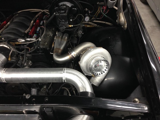

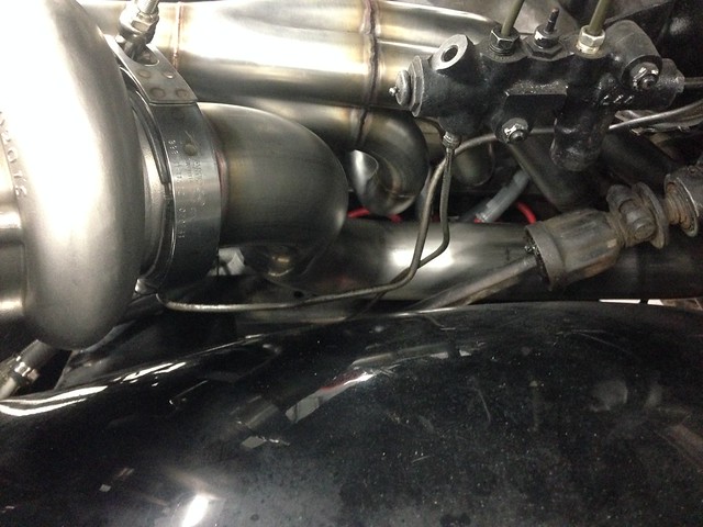

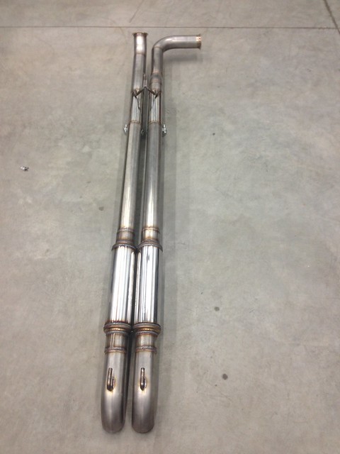

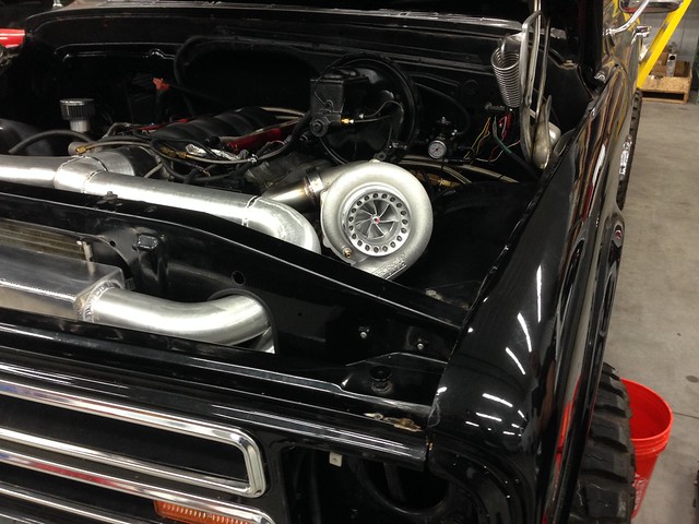

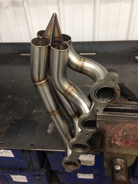

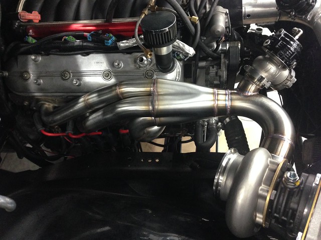

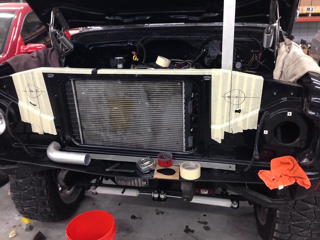

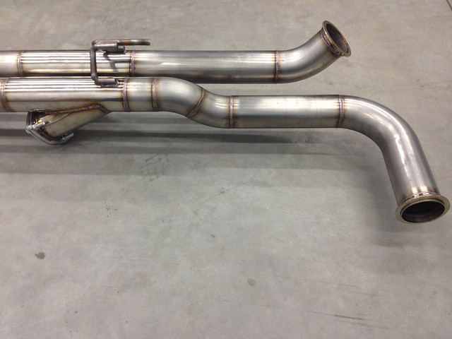

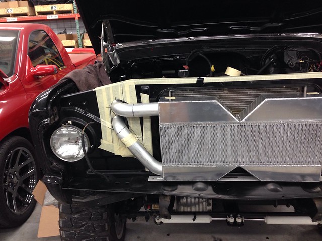

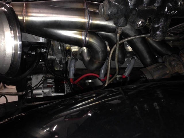

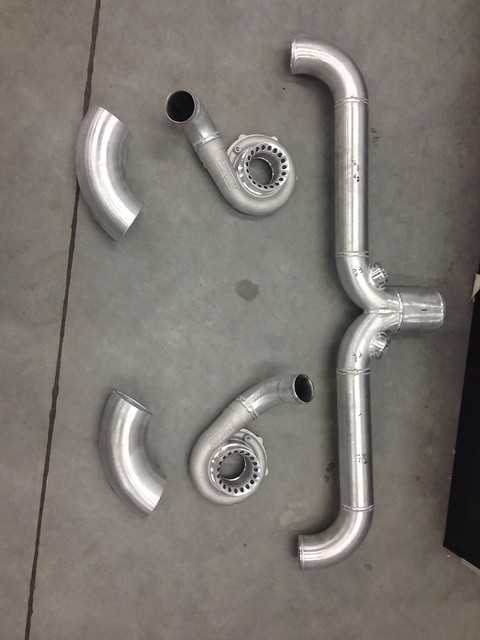

Chad brought his awesome K20 work truck for a twin turbo system about a week ago, we jumped right in to the project. Its a forged 408 and we are adding twin Precision 6466 ball bearing turbos, Tial wastegates and blow off valves, and custom everything else to go with them. We got the intercooler 90% wrapped up and one header near completion as well as the cold side intercooler piping fabbed up. Plenty to go still, but a good start:

I have a question though... The Intercooler and piping looks like it is all welded together. What if you have to remove them? Or pull the motor?
Wow looks amazing!
There is a coupler at the throttle body and where the piping passes through the radiator support.
Damn that piping is beautiful. One day I want to learn how to make welds like that.
