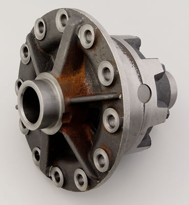

You don't think this will take our "C-clip"? Stink?
Brand: Strange Engineering
Product Line: Strange Detroit Locker Differentials
Part Type: Differential Carriers
Part Number: STR-D3535
Aftermarket Carrier Style: Gear-style locker
Cover Bolts: 10
Carrier Series: 3
Axle Shaft Spline Quantity: 35
Manufacturer of Axle: Dana
Carrier Material: Steel
Quantity: Sold individually.
Notes: Fits 3.54-4.10 Spicer gear ratios and U.S./Strange standard gear set.
Differential, Detroit Locker, 35-Spline, Dana 60, 3 Series, Each
Quick
If i had a part number I would gladly help and try and find out, but as of yet i have found nothing that does work, a picture dont help:eek:
edit let, me find out for yuns
If you contact strange, i believe they sell c clip eliminator for the dana 60. i its just a retainer plate,:)
yep they do, but and dont remember but i dont think they will work on our axles, or the brake set up, but i will call and talk with them tommorrow about it

The Dana 60 with the C clip is a tough nut to crack. I have researched this also.
I have been up at Summit in the past and couldn't find a fix (before Stinker's axle). Not saying this won't work, but I would be surprised.
I am still on the stocker, with a spare cryo'd in the garage. Once again, before Stinker made a kit.
It comes down to actually, buying what you think will work, and then being a test case on the install. Expensive route if it doesn't work.
so which is better????
c-clip or non c-clip?????????
The reason why I posted it was because I saw a similar kit being install on a Chevy limited slip rearend (similar to ours with spider, side gears, and clip) that worked and very easy to install. Easier than getting those spider gears IMO (No special tools required everything just slid in silky smooth). I was on a show called Gears on Speed Channel and done on a project called Knuckle Buster. I'm sure if you google or youtube it I bet you will find it. I would do it but I'm a little busy at work. If nobody has found it I look for it when I get home tonight.
they are checking at this moment, now they are not saying it cannot be done with alot of fabrication, but at the moment they dont know of a c clip eliminator that will work with our eom axle ends, Dodge did something different with them and they dont know of any that will work.
now we may be able to contact mopower1958, to me he may be more knoweldgable on the axle ends and may be able to tell us.
but they are also checking with detroit to see if they have a locker for the c clip axles yet
ok, nobody offers a c-clip locker for our axles, and to my knowledge and DTS's, and I looked around a good bit, but could not find a c-clip eliminator for a dana 60 as most of the 60's never came with c clips
