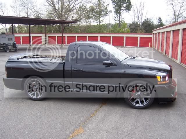

Took my badges off the 06' and had my painter just buff the area the badges were;) Can't see them at all now. It looked terrible until I had buffed. Here's a picture.
