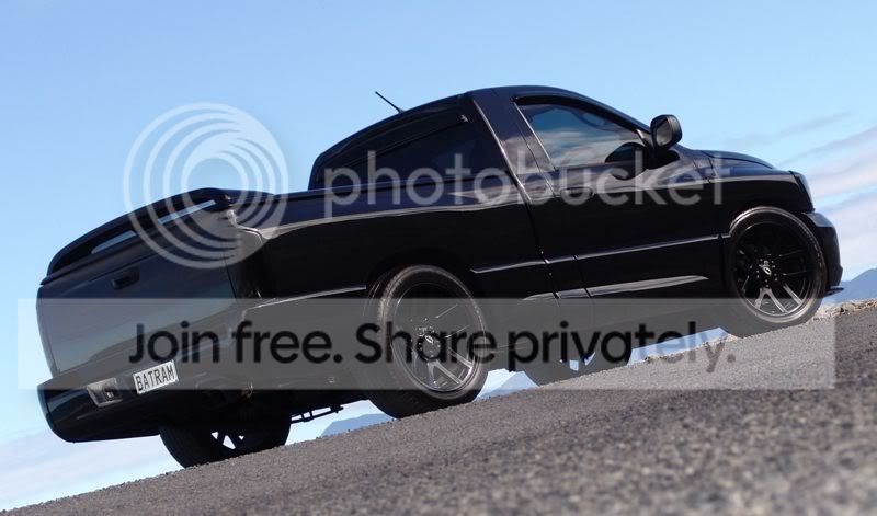

Putting 305/45s was one of the first mods I did and I LOVE it!!! Looks heaps better as it fills in the wheel wells, looks more muscle (suits these hot rod trucks) and I've never been a fan of rubber bands. The traction has definitely improved due to more side wall flex/bite and the ride itself feels more comfortable. Cons? None come to mind, hard to say if it's become a little bouncy as I did a 1/2" front/rear drop kit at the same time. IMO - Go for it.
Cheers,
Carl
