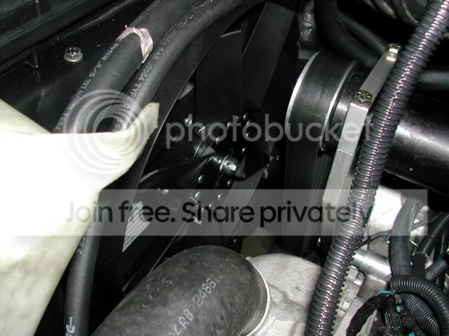

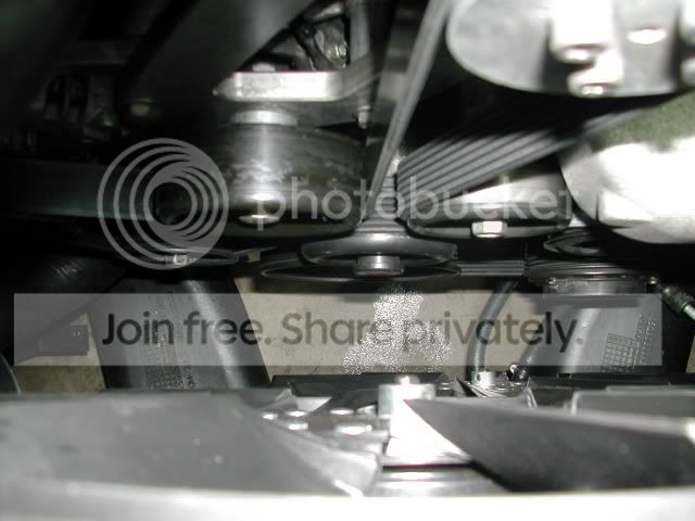

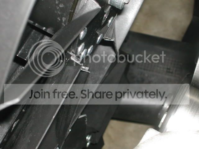

I used a flex-a-lite 295 and it came with all the temp controls. Took out the whole fan and shroud. took out the fan and used the shroud. Laid the fan vertical(since it is a dual) cut off part of the shroud to allow a straight fit instead of circular. It takes a while to get it to sit perfect before you hard mount it. But what a difference. You can get to the belt, to check the bolt on the pulley. Whether it is JMB or you rig your own you wont be disappointed. The cost is alittle bit cheaper but not much. SO if you like tinkering it is an easy project (of course having stingray around to wire it up aint bad either:p )

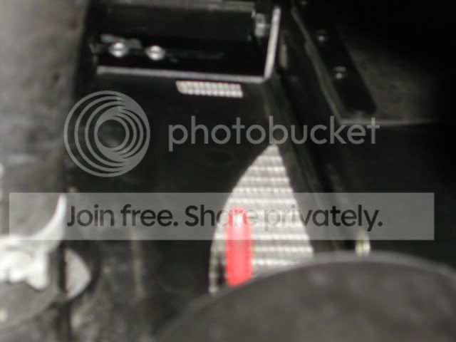

You wanted pics:confused: :aetsch:

Damn that turned out nice..... Nice job man
Why thank you, it i just amazing at the difference in steering and response by getting rid of the hyd fan. I still can't figure out why they used a hyd fan. But then again the electrics where not that good in 04. I can see the 06's though. I dont know I guess thats why I am not an engineer.:itsme:
