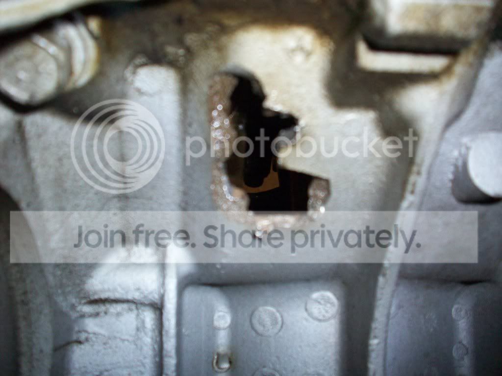

there is a speed chart somewhere, maybe walbert can look it up , I have to run out to get windows tinted for a customer today, but on the oem rods and studs, when I get back I will post up a pic from what happens to a stock set at 700hp, basically you can see thru the block

oem rods and results of 700 hp

Peak-a-boo!! Now that is , what some refer to as, "a windowed Block"
