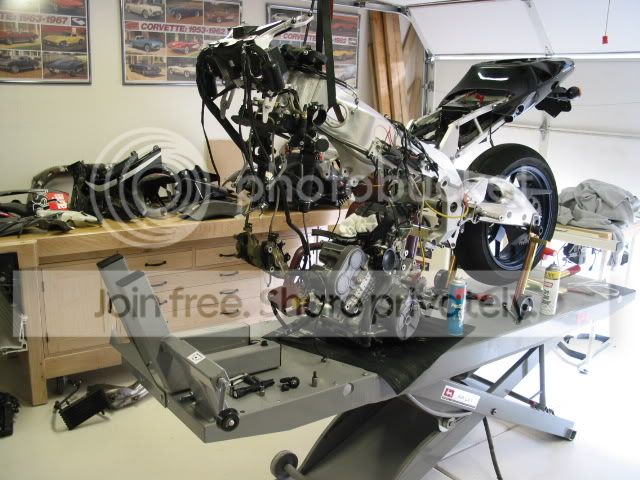

Couldn't have said it any better. I pull a lot of motorcycle engines and no way I'd pull one for simple paint and clean up. Maybe on my 2st bikes but otherwise never. This one took 2 hrs to get out and about 4hrs to get back in.
