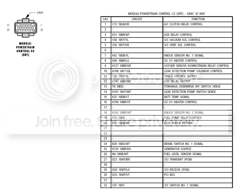

I am installing a Paxton super charger on my 2005 Q/C and want to make sure when I cut into the wiring to the factory ECU Im splicing into the right wires. Any help
hope this helps
Wiring diagram
Thanks to all that has helped I now have the diagram
