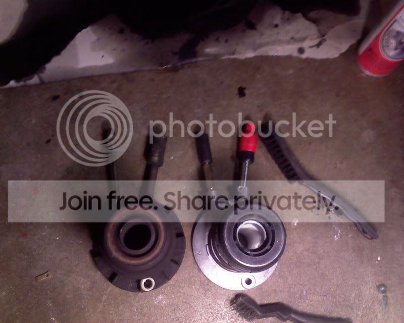

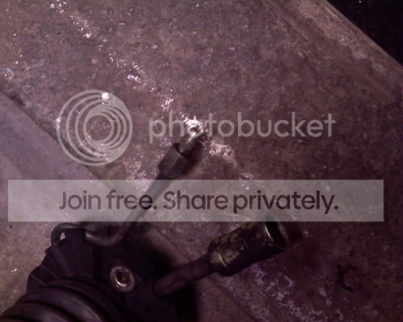

Do you have to thread the new viper slave to accept the bleeder screw from the old slave???
heres the old slave, see how it has the bleeder screw attached
well i can remove it but the new slave Seems like it would need to be tapped so i can screw it in.. wierd...
heres the new slave already installed, but I guess imma have to tap it so ican screw the bleeder in...any insight on this??

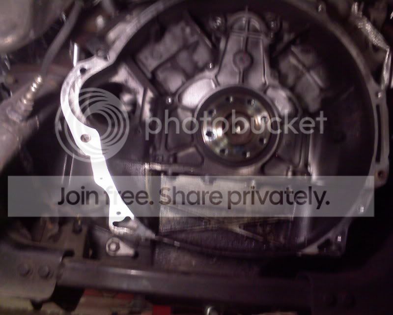

here is the pressure plate and clutch still installed, i wonder how bad it is after 43k miles..
well no clutch pieces falling out so I guess not so bad...but the scoring on the flywheel is pretty bad...you can feel it with your finger and i'm guessing you can tell i dropped the clutch once or twice

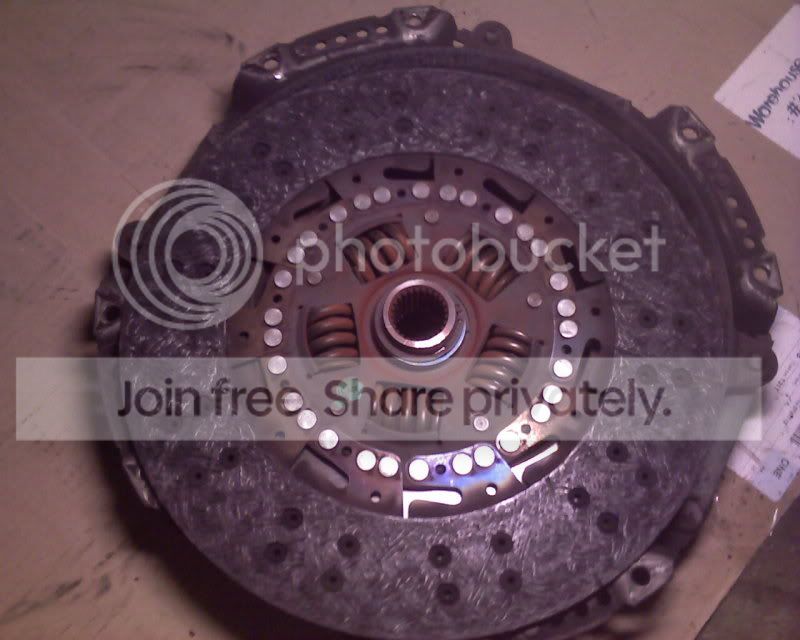

heres is the clutch..it worn down pretty evenly and some of the rivets were already starting to hit the flywheel and pressure plate...I couldnt done this any sooner:D
heres the clutch disc, you can see where the ratchet is pointing that one of the rivets was already rubbing and grinding into the pressure plate

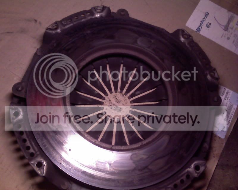

heres the pressure plate itself...lots of hot spots and tons of little heat cracks...besides that not to bad

that is the bleed screw on the Viper throw out bearing:rock: :rock: :rock:
ah really the whole screw, thats what i kinda fiqured... With the game going on bud light cold in the fridge, my dad and I should have this done today.
